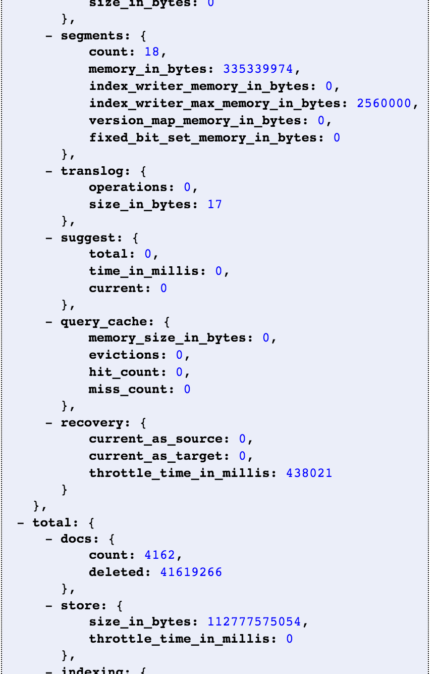

Currently one of the index that we have shows the following stats
The stats show that the total documents count is 2081 whereas a considerable amount of documents are marked as deleted. This has happened I think due to luncene engine's default settings.
We can reclaim the space using expunge deletes option but is it possible to somehow unmark / restore the deleted documents in another cluster or within the same cluster.

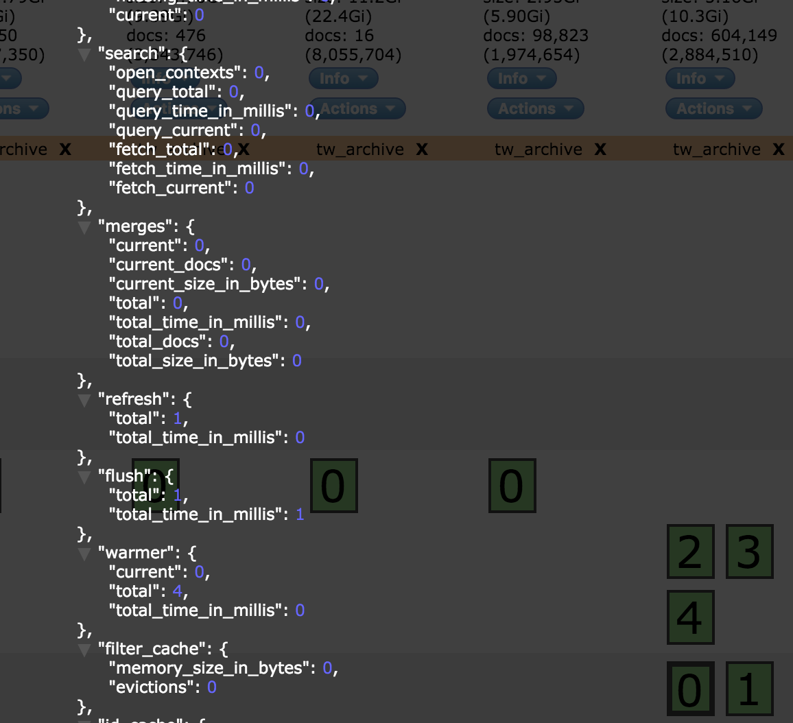

I have checked with the status of the index and it states no-merges have taken place as shown in the diagram below.
I have tried to check the logs but for this index there are no logs detailing any error.

Underneath are the detail screenshots of the index.
If you see in the screenshot in couple of another the same issue has happened - One more addition to it in all these cases the Index has one 1 shard.
