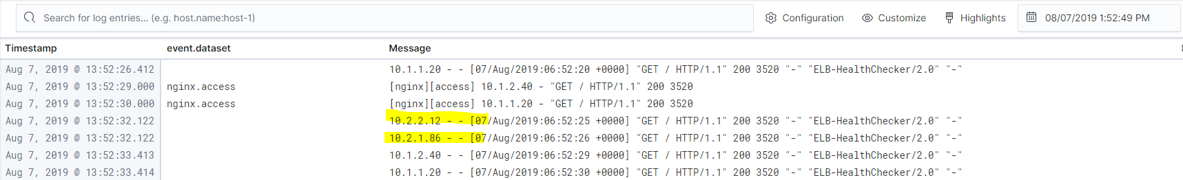

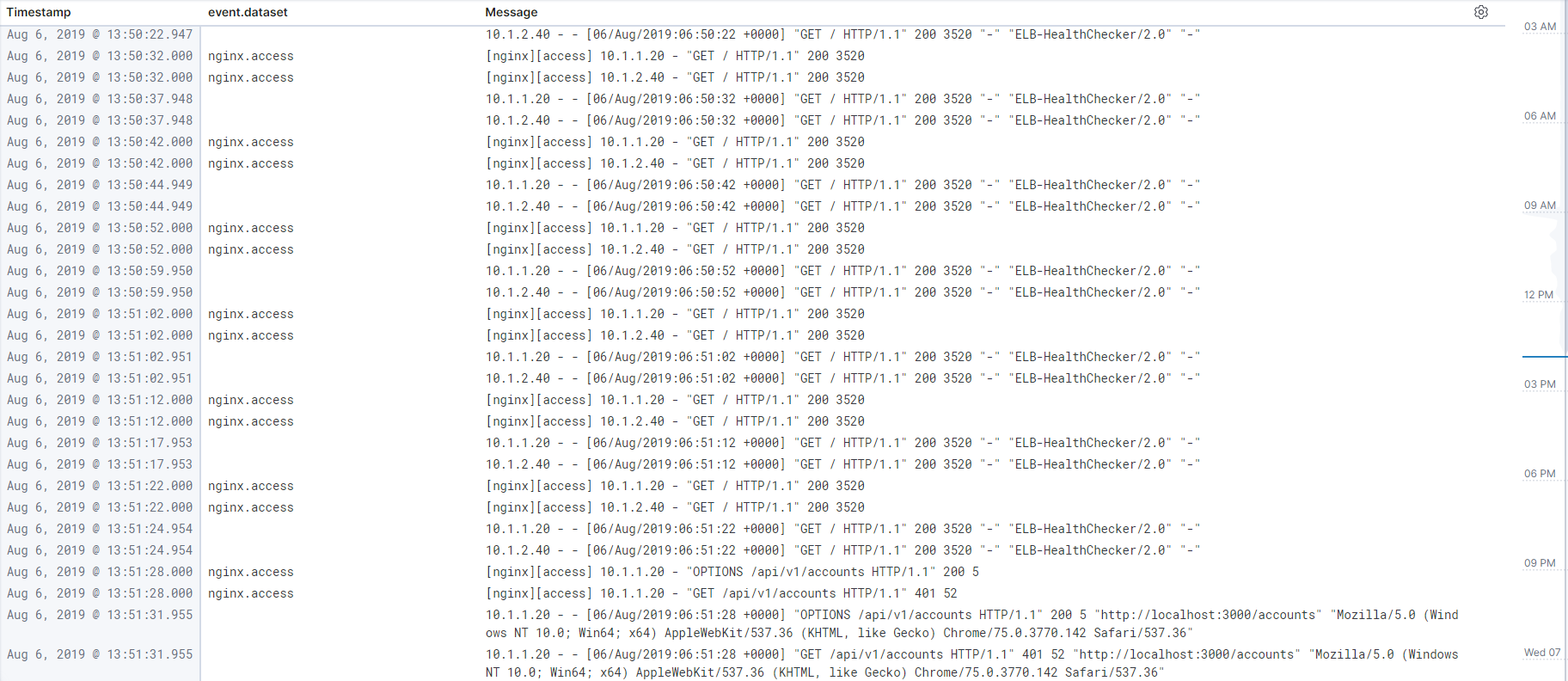

And in /var/log/nginx/access.log I get:
But in Logs streaming I get:
As you can see in access log, logs are same format, but in Kibana, it's missing nginx.access in many records. Can anyone help me in this issue?

Hi,
After investigations, I realize that every record is duplicated. Now I cant explain why it is duplicated :slight_smile:

It's so weird!
I setup Filebeat in another Docker container with the same configurations (nginx, filebeat...), but logs aren't formated in Kibana
Just logs from 10.1.x.x are formated, 10.2.x.x are not
