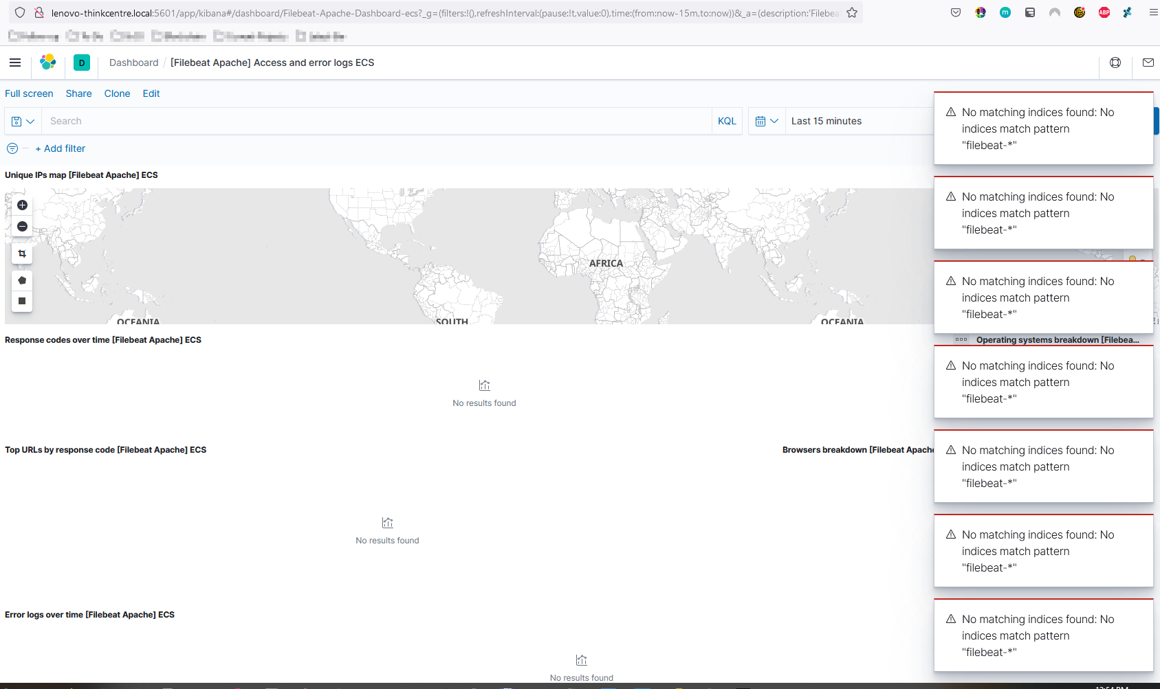

No matching indices found: No indices match pattern "filebeat-*"
Hi All, I have big problem with my recent deploy of ES version 7.8 using docker. I'm trying to connect my filebeat sources, but I have following ERROR in the Stack Management 7.8.0 (see screenshot below). Some of the sources point me into the Roles/Users, interestingely i dont see anything under Stack Management > Roles - any help much appreciated!

So when i try to load any of my dashboards i see this - "No matching indices" (on the right hand):
Hope it makes sense
