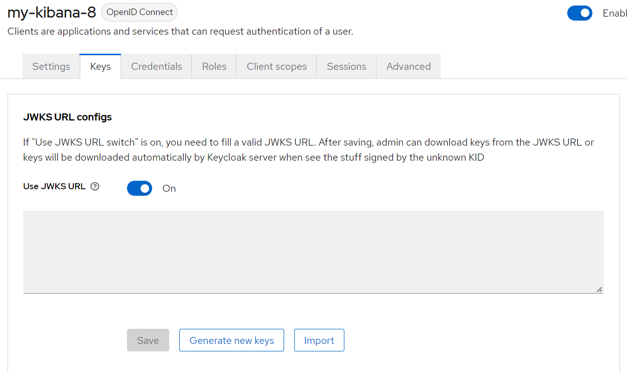

While in Keycloak it shows up in session

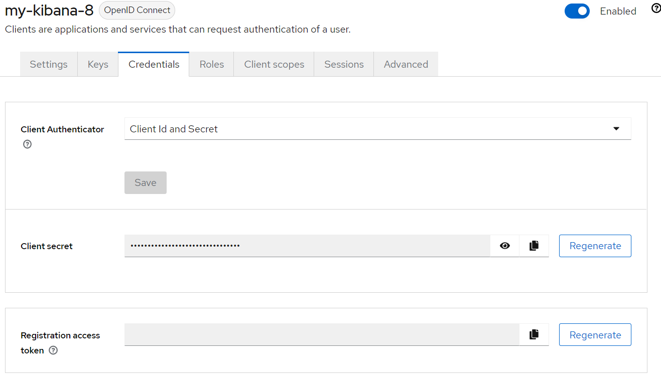

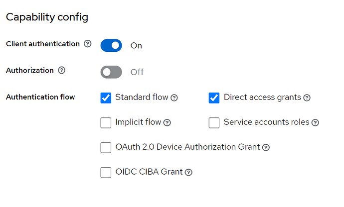

Below are the settings I had made in Keycloak
I have also entered the client secret in bin/elasticsearch-keystore add xpack.security.authc.realms.oidc.oidc1.rp.client_secret.
I have also created a role, shiru in the client and assigned the same to a user (Keycloak).
I have also role mapped (role-mapping) a role shiru with unique name shiru (Kibana).
