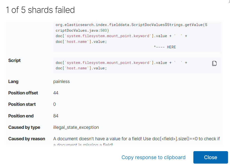

I want to create an additional field in index having combined values of mount point
and hostname.
ex: /dev/run vxw001m001, / vas002m002 ....
when tried to create scripted field in index patter in kibana,getting below exception,tried to work around it but unable to get output.Any suggestion would be helpful
doc['system.filesystem.mount_point.keyword'].value + ' ' + doc['host.name'].value;
Caused by type
illegal_state_exception
Caused by reason
A document doesn't have a value for a field! Use doc[].size()==0 to check if a document is missing a field!
Did tried to check for null values and size,but not sure about exact query
@spinscale can you plz help in this?
Are you sure that this field 'system.filesystem.mount_point.keyword' exists and has a value in every each document ?
@Yazid_S Thanks for your quick response! Yes it exists.
On your screenshot, it seems to be 'system.filesystem.mount_point' not 'system.filesystem.mount_point.keyword'
Mybad,you are correct its system.filesystem.mount_point and it does has mising values,what is the right way to get the desired output?
You just need to add an if statement on ' system.filesystem.mount_point' not null. Then you adapt your script and your output depending on if ' system.filesystem.mount_point' is null or not.
