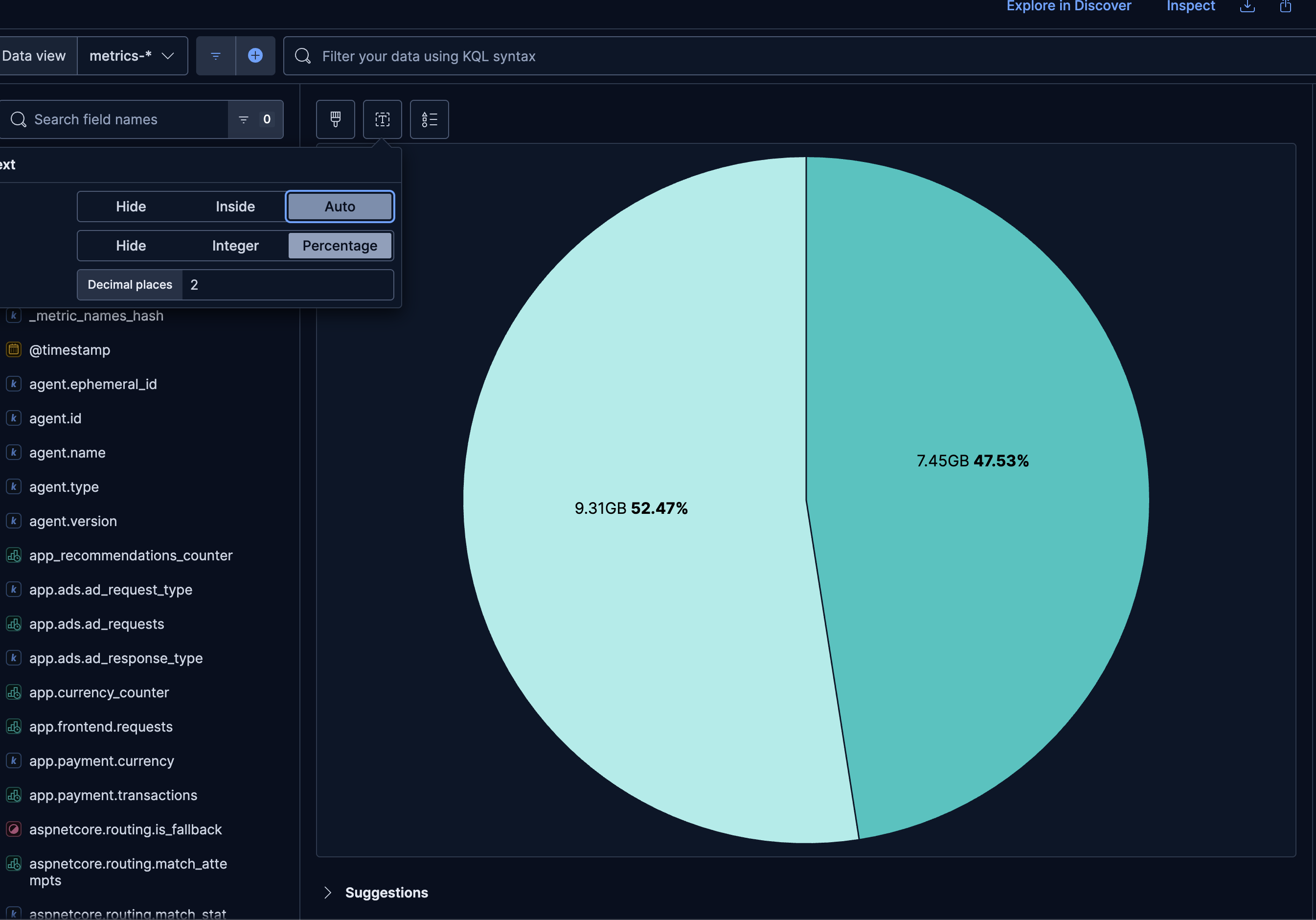

I have a field with the values as bytes:
But I want to display the data on the pie chart as bytes but I only get two options:

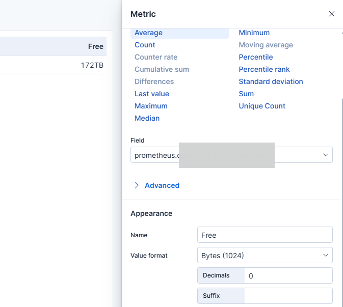

The metric is numerical field from prometheus collector integration. The field contains the number but typically can be converted to bytes in Lens.
I changed the visualization to a table:
If you noticed the number is now formatted as bytes in table visualization (as expected).
The issue is I wanted to show in the pie chart the breakdown by bytes (formatted as bytes)

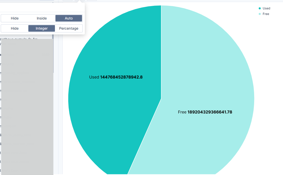

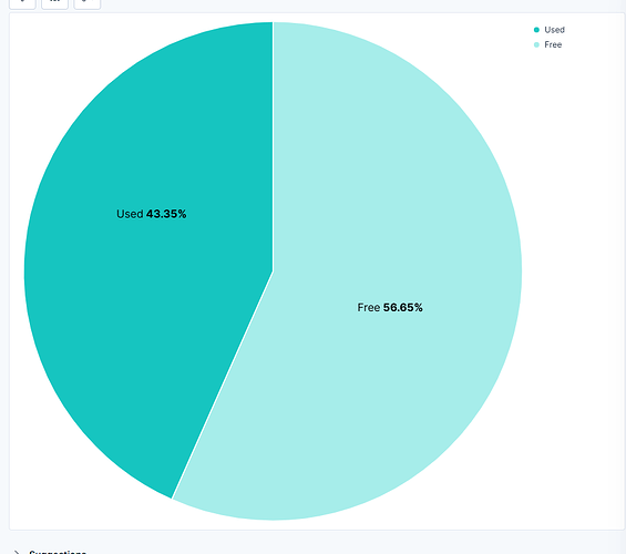

Continuing on, I think I figured out the issue:

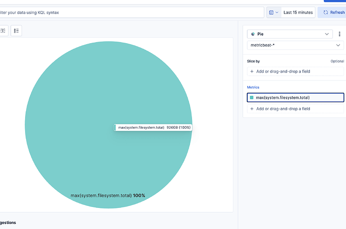

Heres' a better example using common ecs fields:
The issue appears when I try to add two metrics to compare against:
Hopefully this makes more sense:

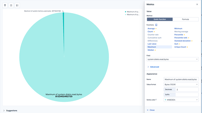

Use Lens Latest S
Pie Chart
Layer Setting multiple metrics
Use 2 byte metrics
I set the format in each to Bytes
I also set in the data view to Bytes
But the number in the pie chart is just a long not friendly Bytes... if I only have 1 metrics I get bytes
I can reproduce the issue.
I've opened an issue you can track here about it: [Lens] Pie chart in multiple metrics mode doesn't apply correct format to values · Issue #229644 · elastic/kibana · GitHub
