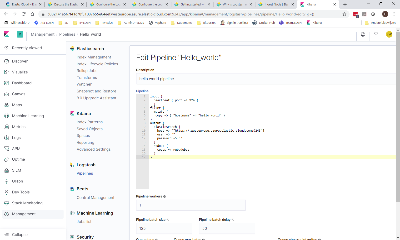

Within the Management section I have created a Hello_world pipeline
(I have editted the screenshot: the host, user and password)
To check if this pipeline works, I used the Dev Tools. But I get an error saying it is an illegal_argument_exception. status = 400
What am I doing wrong?
Is there other information, I have not found yet?
You are confusing centrally managed Logstash pipelines with ingest processors that run in Elasticsearch itself.
With Elastic Cloud you can still use Logstash if you want to; it needs to run on an additional server that you provide and control.
However, if you prefer to do any data transformation in Elasticsearch itself and just send the data in packaged up in JSON format, use an ingest processor.
