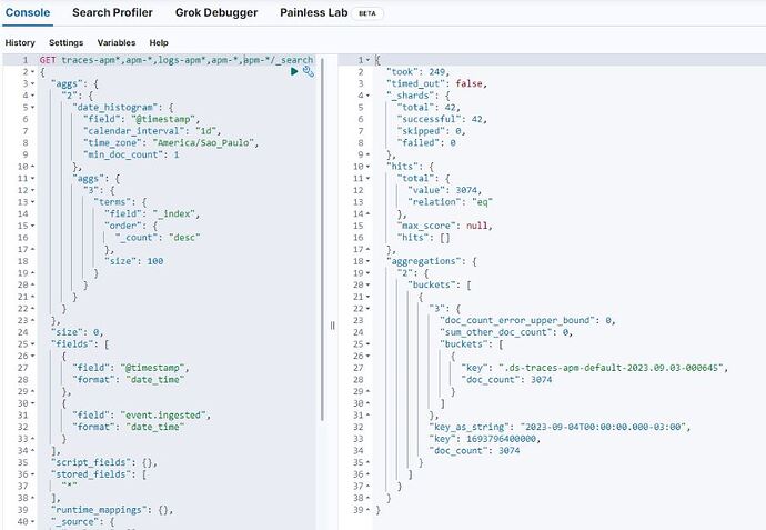

I created a visualization with APM dataview, without any filter or aggregations, at this moment I have one value to count property (5598). When I put a date histogram aggregation the count total is bigger than when I haven’t (8792).
So, trying to understand the situation, I analyzed the requests.
In the result, we can see a difference between "value" of "hits" and "buckets.doc_count".
This difference happens because of the index of data streams "metrics-apm.*.1m-default".
Removing this index from request, the number of "hits" and "doc_count" is the same.
Is the presence of this data stream (metrics 1m) in the default "APM" data view expected?
Why only this data stream 1m aren’t hidden? The other similar data streams like 10m and 60m are.
Thanks!

In my case, my problem is just the opposite. I’m trying to get the exact count without APM metrics information because I noticed when the data view has these metrics information, it multiplies the result. I used the default APM data view, that contains “metrics-apm*” indexes.
Getting around this situation, I created a data view without “metrics-apm*” indexes. This way, using this new data view instead of the APM default data view, I could see the correct number of hits in my visualization.
So, is that the correct approach, not using APM default dataview to create custom visualizations?
