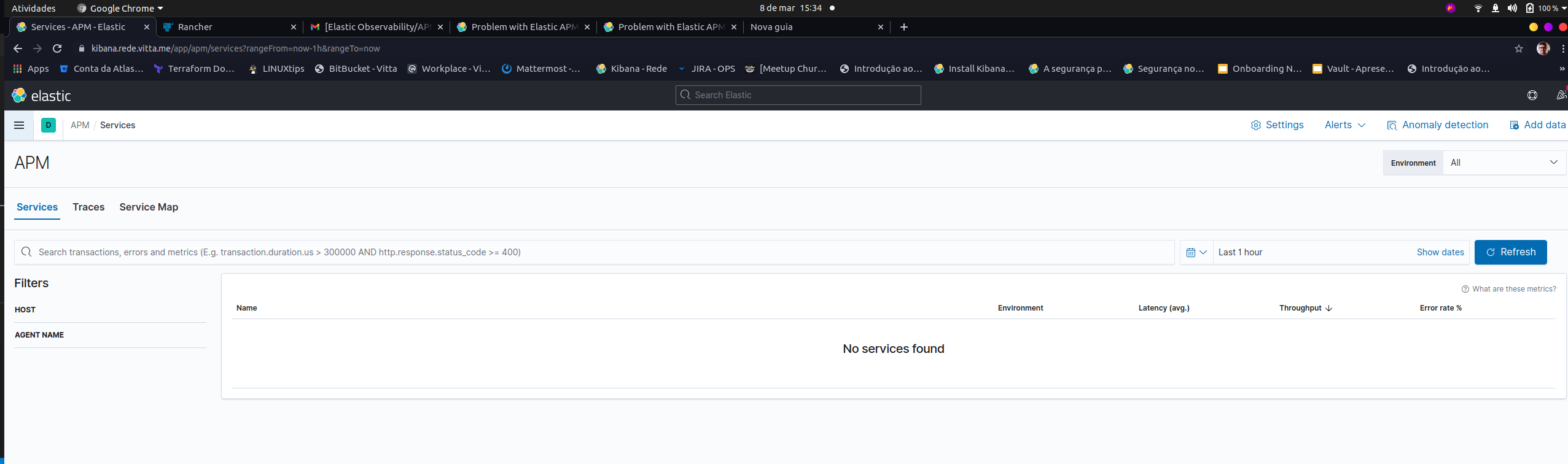

@stephenb, not success bro :frowning:
Look this...
Created index default...
But not showing in the APM
I do not know what to tell you at this point. Did you expand the time frame?

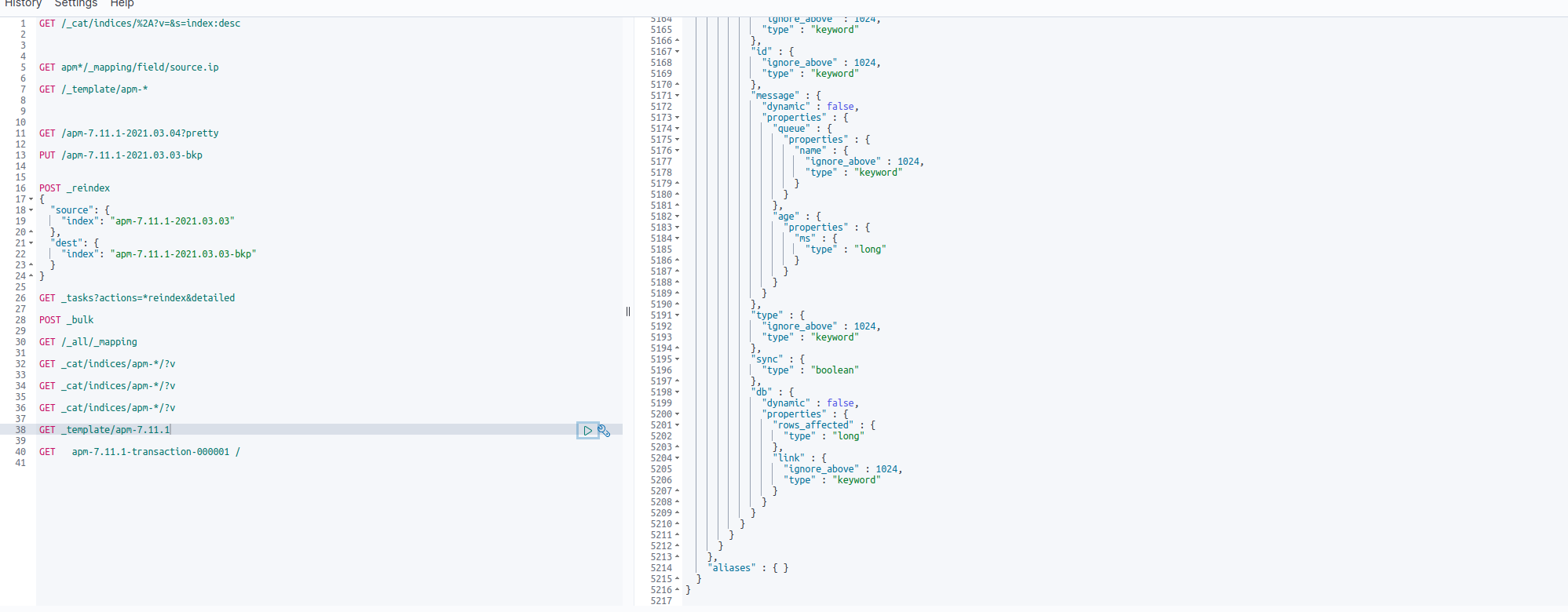

Sorry, I got the index..
Look...
Ahhh now we are getting somewhere... that mapping is NOT correct for GET apm-7.11.0-transaction-000001/ I can tell because I see those fields like version
that have both text and keyword
This is wrong, that is a default mapping ... the template is not getting applied.
    "version" : {
      "type" : "text",
      "fields" : {
        "keyword" : {
          "type" : "keyword",
          "ignore_above" : 256
it should be something like
        "version" : {
          "type" : "keyword",
          "ignore_above" : 1024
That means the template (_template/apm-7.11.1) is not being honored... that is why this is not working, somewhere you have disable the template / ILM etc. most likely in the apm-server.yml.
