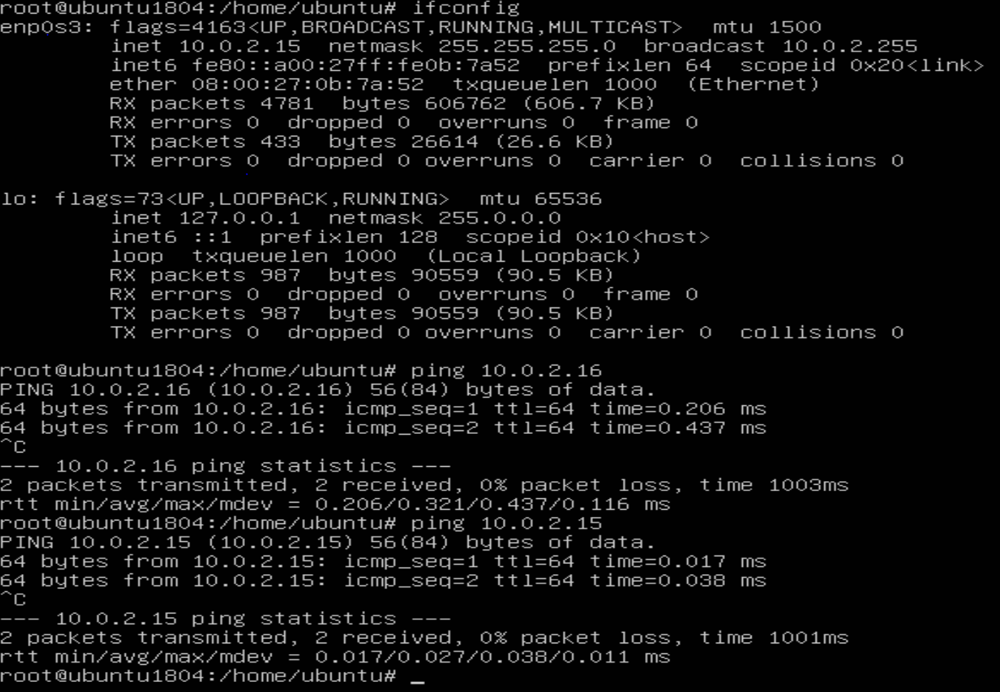

I have 2 virtual Ubuntu machines:
        1. Realize that both could be seen.
        2. Ping to see if they are calling between them.
"the previous image is of a virtual machine called Ubuntu 180"

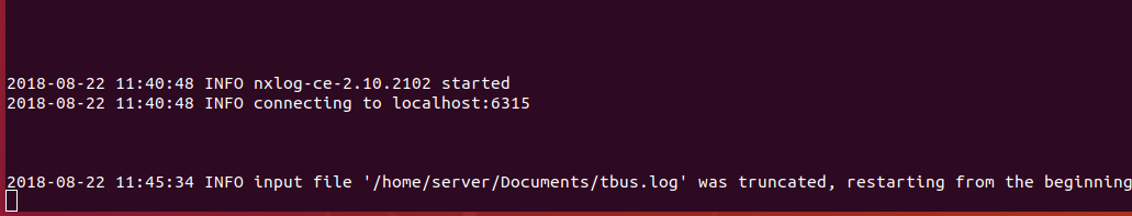

My configuration in /etc/nxlog/nxlog.conf is as follows

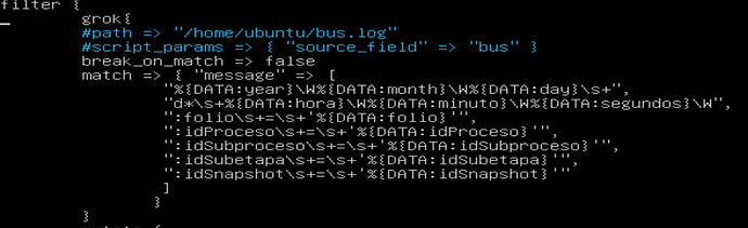

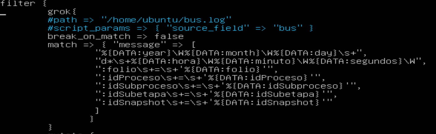

My configuration in /etc/logstash/conf.d/tbus.conf is as follows.
The logstash file is already in use and if you start the problem that I have serialized in the Logstash INPUT and in the NXLOG in your configuration.
   1. In NXLOG in its configuration in the host I put the ip 10.0.2.15 but not
       it worked, now I tried it with localhost and it did not work.

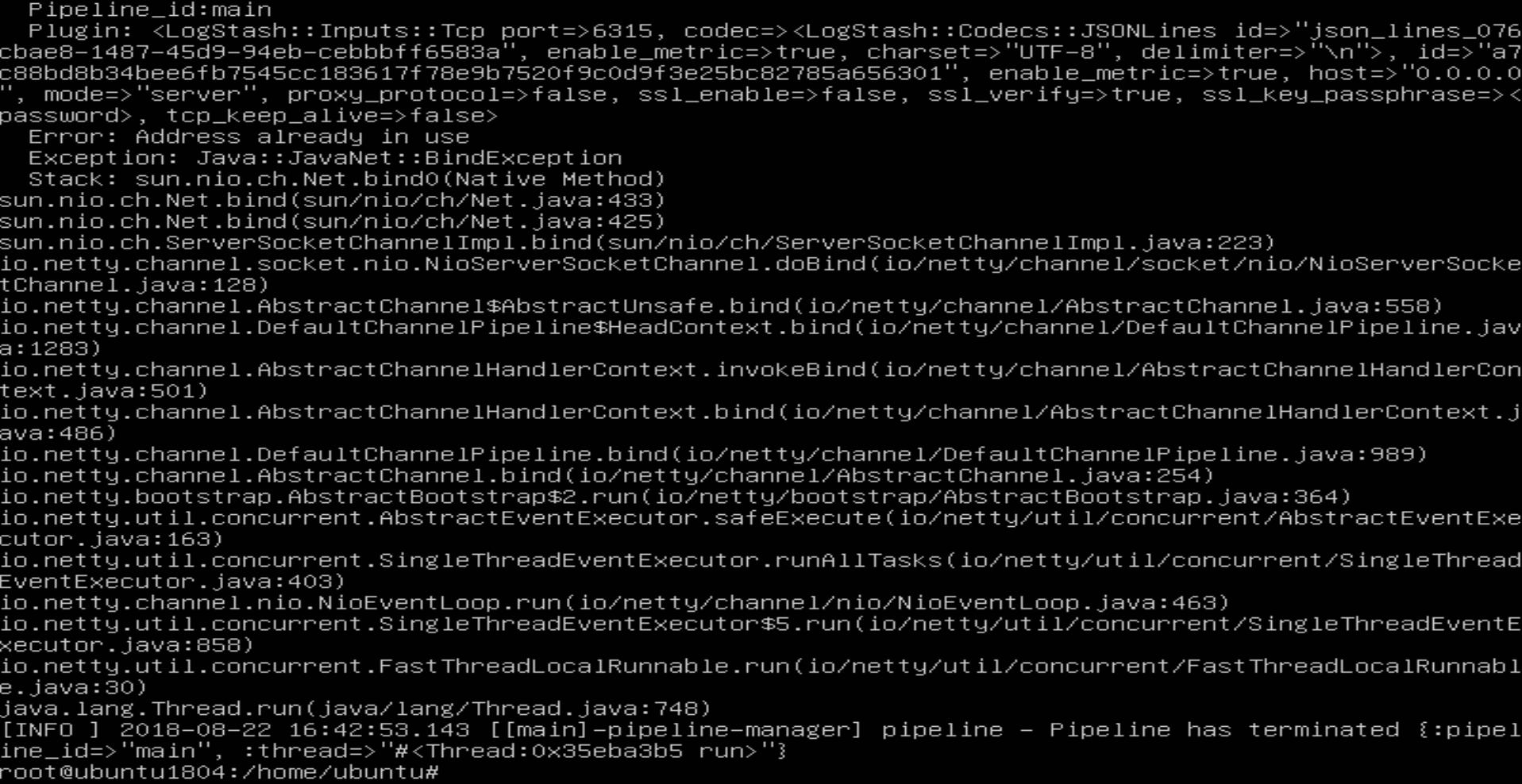

   2. In the Logstash you add many things but for some reason when you do not
       I put the mode => client shows java error and with the mode: client does not show
       A java error shows another error that acontinuacnion will show.

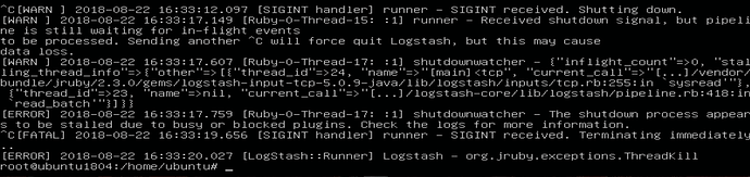

I'm going to run the logstash file that contains the mode => client
Do not mark any errors run normally
But then it marks this type of error and that it is not loading the file or it is blocked, I do not know what the problem is if both are pinging
This is another type of error when I run logstash removing the mode => "client" this comment to execute it. Because I have no idea what's going on
NXLOG from the other virtual machine tells me that if it is connected but it appears that the file reopens
