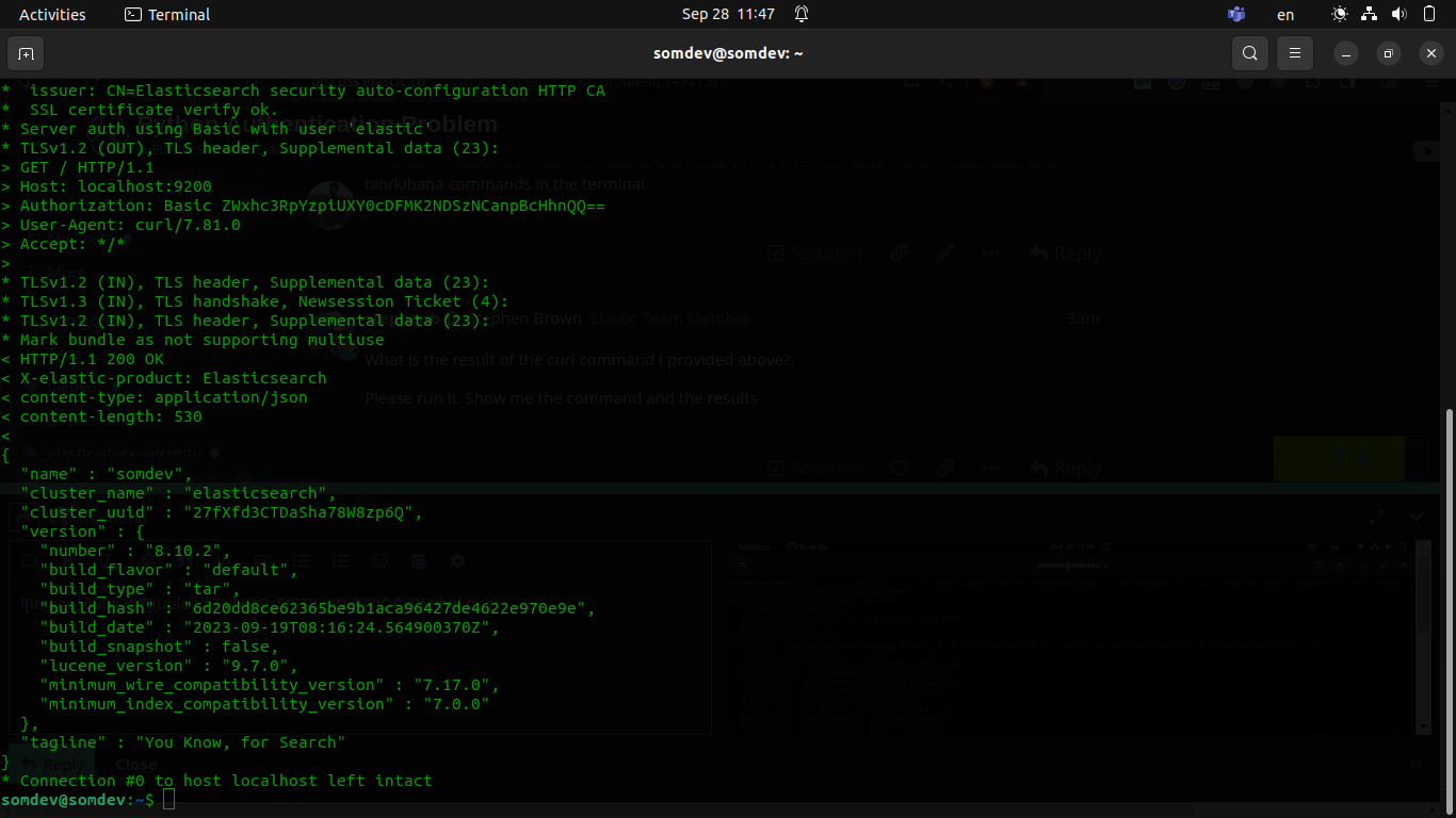

Can you curl with same config?
curl -v -u elastic --cacert /path/to/ca.crt https://localhost:9200

What is the result of the curl command I provided above?.
Please run it. Show me the command and the results
Hi @Somdev_Das
Again Please do not provide images of text. It's nearly impossible to read. It cannot debugged or searched.
The curl looks good.
