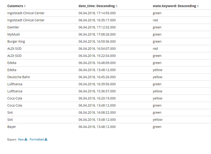

Here are the two screenshots of my data representation:
The first is the logs for the customers, their states and the date the log is written.
I would like to be able to count the number of customers they are currently in greens, reds and yellows state.
In this example, when I query red, I should get 1 since Ingolstadt CC turned to green later OR when I query for green, the reult should be 8 AND for yellow, the result should be 2.

OK so it looks like the state transitions aren't always in the same sequence so my arithmetic suggestion wouldn't work. You need to consider each customer individually.
If you have many (eg hundreds of thousands plus) of customers then this causes the "bucket explosion" problem referenced in my video link.
This will be too much work to attempt in a single query. You can try use term partitioning to break the analysis into several smaller queries. The docs even include an example of how to get the latest value for each ID. This will not play nicely with Kibana though.
Using the entity centric example I gave the cons are a more complex indexing strategy but the pros are faster, simpler queries and Kibana-compatible indexes
