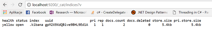

RabbitMQ panel
But there is no index created so ofcourse I cant see any logs in Kibana
