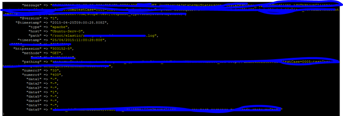

for the timestamp parsing i don't have any _grokparsefailure or _dataparsefailure :
And in Kibana discover i can't stop the automatic generation for the @timestamp . see the picture
Thanks
Logstash will always produce a @timestamp field and Kibana relies on that field. Is this a problem for you?
Hi,
Yes that is my problem :slight_smile: , can i resolve it ?
As I said, Kibana relies on the presence of that field. Why is that a problem?
(Perhaps Kibana 4 allows the name of the timestamp field to be configured. I haven't checked.)
Kibana generate a logs automaticly, with type logs or syslog, what i want is to stop this generation or to not display it in the discover, i wanna to kibana to read just the logs from my file logs and display it
Kibana is a tool to visualize logs over time. For the "over time" part to be useful there must be a notion of time in the data, and the idea is to have Logstash extract that from the logs (and it happens to store it in the @timestamp field). If you just want to display the raw logs I'm not sure what use Kibana is to you.
