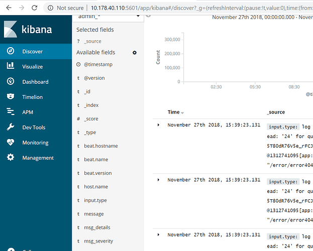

Hi ,
suppose in log file i have 1000 entries with different dates.
In my kibana dashboard time showing as 27th Nov for all the entries (but on 27th I added only one entry ) as shown below screenshot.
Now suppose tomorrow i update my logfile again manually/auto with one log entry that time my complete kibana time would be 28th Nov.
Image1:

please see in below screenshot, kibana date is 27th Nov (image 1) and event date is 19th Nov (image 2)
Image 1:
Image 2:

Are you sure your application is not rotating log files causing them to be read again? I.e it move adminserver.log to adminserver.log.1 then adminserver.log.2 etc etc?
Hi Lewis,
first, I would like to tell you it is my Lab server. on daily basis, i copy the log from my real environment server to lab server for POC.
yes, my application becomes log as adminserver.log.1, adminserver.log.2., etc, etc.
but what I did, i copied all the log data from all the files to one single file.
Ah, then filebeat will see it as a new file and re-read it I think, thats why you are getting everything ingested again!
why, file is same just adding the new files content in one file (append mode).
Yes in appended mode.
As i am new user this thread not allowing to reply now as i have crossed my 21 limit. so i m replying on same again and again.... Please bear me
Are you overwriting the file like you said? Or appending to the end?
Hi Lewis,
i tried to reply but my limit expired so i cant reply.
