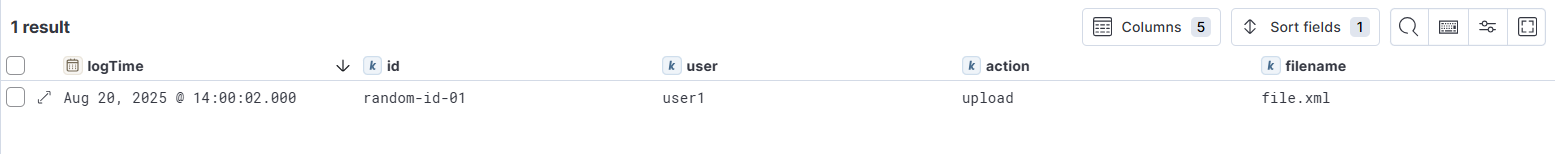

Using ES|QL we can get the aggregated record :
FROM test-message
| EVAL
    user = REPLACE(CASE(message LIKE "* connected*", message, null), " connected", ""),
    filename = REPLACE(CASE(message LIKE "*uploaded*", message, null), "uploaded ", ""),
    action = CASE(message LIKE "*uploaded*", "upload", null),
    disconnect_time = CASE(message LIKE "*disconnected*", logTime, null)
| STATS
    logTime = MAX(disconnect_time),
    user = MAX(user),
    action = MAX(action),
    filename = MAX(filename)
    BY id
| WHERE logTime IS NOT NULL AND user IS NOT NULL AND action IS NOT NULL AND filename IS NOT NULL
| KEEP logTime, id, user, action, filename
| SORT logTime ASC
Thanks!!
