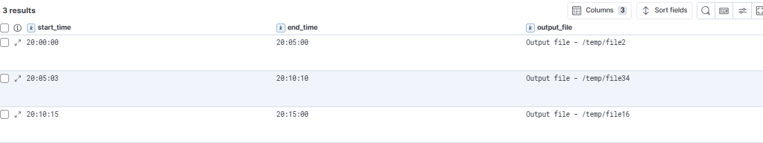

Incase you have any common id like used in above records than Using ES|QL :
FROM 02aug-req
| STATS
    start_time = MIN(CASE(message LIKE "*Started*", time)),
    end_time = MIN(CASE(message LIKE "*finished*", time)),
    output_file = MIN(CASE(message LIKE "*file*", message))
    BY id
| WHERE start_time IS NOT NULL AND end_time IS NOT NULL AND output_file IS NOT NULL
| KEEP start_time, end_time, output_file
| SORT start_time ASC
Thanks!!
