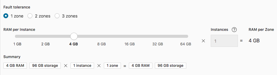

Thanks for insights. I'll keep testing with more resources, but that wasn't working on Friday when I tried as well. Any idea why I cannot increase number of nodes from admin console?
49
But the input box to increase number of nodes (instances?) is disabled and grayed out?
This is monitoring
On Elastic Cloud you always scale up by increasing node size until you reach the largest size 58GB/64GB. This is because it is more efficient to do so than to run lots of small nodes as there is less overhead. From that point on you scale out and nodes.
OMG, that was not intuitive at all. Please suggest to product team to add tooltip or popup on that disabled instances input field to explain that you must first increase to 64GB to add a second instance.
So is the suggestion instead of multiple nodes to just add another zone for redundancy? I cannot justify the expense of a 64GB node, just to be able to add another node, to have HA.
You can add availability zones at any size, which will give you up to 3 nodes. This will give added resiliency but also potentially better performance.

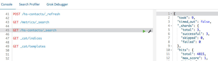

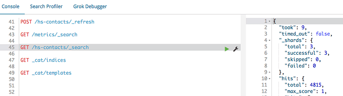

I just upgraded to a 16GB 2-zone cluster and it added a 1GB "tiebreaker" node. 33GB RAM and same issue, not even able to index 7,128 records.
Only 4,815 docs in index after _refresh
Incremented counter reveals 6,176
