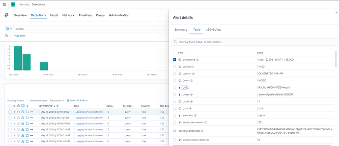

So I have been doing some experiments and there is indeed an hidden index called: .siem-signals-default-*****
which contains the the event that triggered and the rule relationships in the signal document.
It seems not a big deal to write an injector for that but any documentation on that index is welcome.

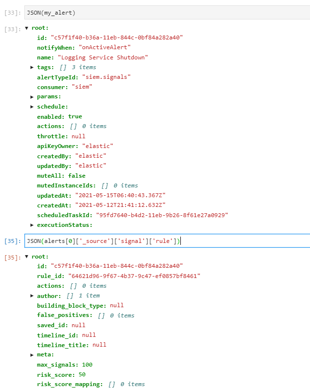

I managed to butcher a solution and generate an alert directly into the index, is working but not elegant.
What I discovered is that the rule object nested inside the alert is not identical to the rule object you get from the kibana api.
The one from the API has very few fields compared to what is inside the siem index.
For now I do like this:
  1. for each rule
  2. generate 1 trigger event from the past
  3. copy the rule object from the test event
  4. add the new event information
