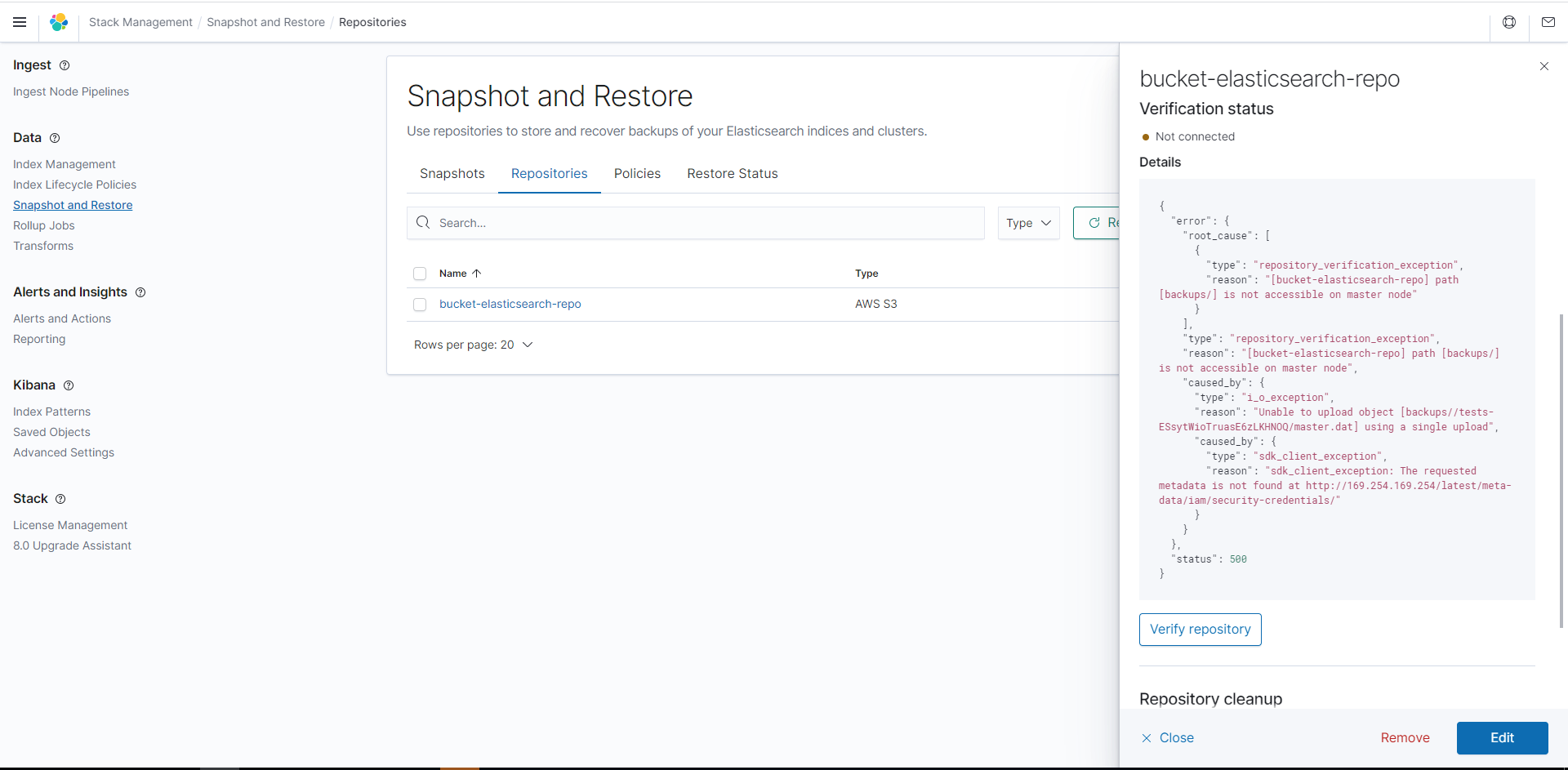

I'm trying to configure AWS S3 repository for backups but facing access issues to the S3 bucket.
I did the following steps:
  1. Installed repository-s3 plugin on all cluster nodes
  2. restarted all nodes after the plugin installation
  3. I'm using elasticsearch-keystore to configure the credentials for S3, I have set up both s3.client.default.access_key and s3.client.default.secret_key.
  4. Configuring the repository through Kibana and getting this error when I'm trying to test the repository:
    Seems that it tries to get the credentials from attached IAM role rather than using the credentials in the keystore.
How can I make it consider the keystore configuration?
Thanks,
Lior
Hi @Lior_Yakobov,
Can you confirm that you've set up the S3 credentials in all ES nodes?
Thank you!

There is no need to restart Elasticsearch, although you might need to call the /reload_secure_settings API to get all the nodes to re-read them: Secure settings | Elasticsearch Reference [7.10] | Elastic
Hey @afharo,
Thanks for the heads-up, I probably missed it.
So after running the reload_secure_settings request I do see that test files were created in the S3 bucket, but still Kibana complains about something else now:
