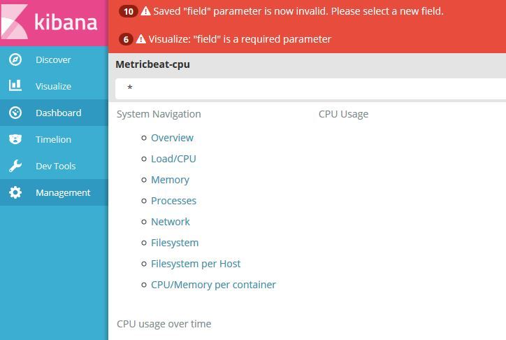

Saved "field" parameter is now invalid. Please select a new field. .... Visualize: "field" is a required parameter

Hi @Stacey_Gammon-
I ran the import script and didn't refresh the fields, I DON'T see any error message on the dashboard now.
But, I believe, Metric beat is sending empty data, so no results found message is displayed.
Hi Stacey
I am running metricbeat and my LOAD/CPU visualisation has this error too, I need to find out why metricbeat is not reporting this information
Any help appreciated?

Actually this isn't an issue any more for me, fixed with changes to the metricbeat config
Hi @matt.dunks-
What was the changes in the Config file you made? Please let me know. thanks !
It was simply a case of re-reading the full config and then enabling more options
metricbeat.modules:
  • module: system
    metricsets:
    • cpu
    • filesystem
    • memory
    • network
    • process
    • load
    • core
    • diskio
      enabled: true
      period: 300s
      processes: ['.*']
      cpu_ticks: true
There are a couple more options in the full config which I haven't used
When the new index started the data for the other graphs populated and now all graphs work with no errors
Hope that helps you
