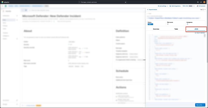

I want to use a Webhook connector to send the alert data to an automation platform.
The issue is that in the Connector action, I can't find a way to send only the JSON alert information. As marked in the image.

I want everything related to the alert. The JSON tab in the alert contains just that, but I can't send it via the webhook connector.

It does not exist in the json, the fields is how Kibana shows the fields that are indexed in the alert index.
When an alert is triggered it will be written into an internal index, and this process probably will do some parsing on the fields before indexing.
When using a webhook you have access to a couple of fields like context, rule and alert and you can send those fields to your destination.
