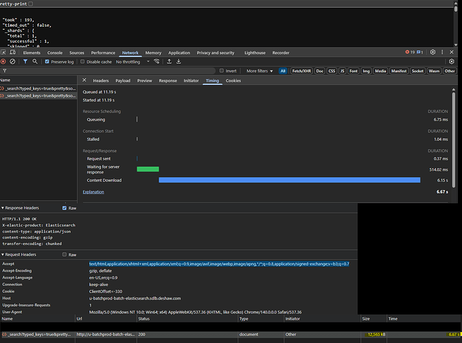

The same Search request when hit via the browser (The browser is in Hyderabad India, and the ES is in NYC. However, that’s not the case with the Java application, the application and the ES runs in NYC itself. ):

This is called when receiving the start of the HTTP response, so you are not accounting for the time it takes to download the response body.
Also JSON parsing is not free, it can be quite allocation-heavy (particularly if parsing 2000 hits from the response).
You probably need to attach a profiler to see exactly where the time is being spent, but I would imagine it’s one of these two things.
