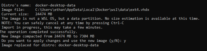

Earlier on, I also managed to compress the /.vhdx disk using the wslcompact utility.

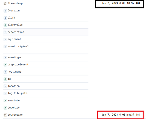

Timezone is now a funny issue i would like to understand better.
In order to get @timestamp right, I had to In my pipeling config.
    "date": {
        "field": "sourcetime",
        "timezone": "America/Los_Angeles",
        "formats": [
          "yyyy-MM-dd HH:mm:ss.SSS",
          "yyyy-MM-dd HH:mm:ss.SS",
          "yyyy-MM-dd HH:mm:ss",
          "yyyy-MM-dd HH:mm:ss.S"
Which then gives me @timestamp in accordance to the correct and original sourcetime.
But, the sourcetime itself is now 8 hours ahead.
Why can't @timestamp and sourcetime be matching?

Date Format is a little peculiar for the csv files. Its populated in this manner. File Upload happened to detect several formats of the date within 1 day's worth of data.
For the date processor, "timezone": "Asia/Singapore" (UTC+8), but I changed it to "timezone": "America/Los_Angeles" (UTC-8), because I realised Elastic will +8 hours to each @timestamp and sourcetime.
Since I noticed @timestamp is the basis for visualisations esp for TSVB, I realised my timezone setting had to be UTC-8 in order to negate the offset.
Using timezone": "Asia/Singapore" (UTC+8)
@timestamp: 08:00:00
sourcetime: 16:00:00
Using timezone": "America/Los_Angeles, could give me the sourcetime original value parsed into @timestamp.
@timestamp: 00:00:00
sourcetime: 08:00:00

I see the difference. One json has target_field and the other doesnt.
      "date": {
        "timezone": "Asia/Singapore",
        "formats": [
          "strict_date_optional_time",
      "date": {
        "target_field": "sourcetime",
        "formats": [
Look closely they are not duplicates.... Read the docs...
Right so no target_field defaults to @timestamp...
Or you can explicitly set it so it clear...
Name Required Default Description
field yes - The field to get the date from.
target_field no @timestamp The field that will hold the parsed date.
I saw this under Date processor | Elasticsearch Guide [8.11] | Elastic
Broadly, I saw having 2 of the same objects as a means to offset the Time Difference? ITs an interesting technique u did if I understood correctly.
I use date processor to set the timezones for both sourcetime and the @timestamp ....what you asked for ... It's just code to do that ... If this is clearer
"date": {
        "target_field": "@timestamp",
