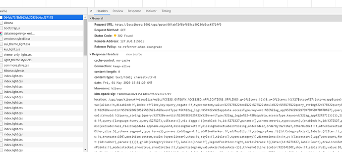

After observing the calls of localhost kibana setup on pasting Copy link short url from paramalinks in another tab , i found out a redirection is happening with status code 302.
Even the response is containing a location attribute which is having the snapshot at a particular instant.
Network call in my case is https://serverAddress/amdashboard/proxy/goto/ef23b6a4f287e80ff0820ac3251b48ba
is responding me with 404 and no location attribute attached in response.
No redirection is happening .
Please help me to fix this.
Attaching local host image down.

I also noticed you seem to access to Kibana via https://serverAddress/amdashboard/proxy/goto/...
But in the screenshot you have http://localhost:5601/zgc/goto/....

But why the browser traces show a different url?
Actually i was working parallely with two setups one with local host server, other with different server address.......in local host it is working fine....but in my server it is failing for sort url.

In the server.har file you've shared, the request to /amdashboard/proxy/goto/02b0323c1012b0dc2bdc58c041cb46f3 returns 404, meaning it doesn't exist.
