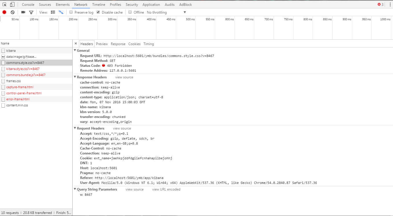

Hi,
I seem to face a peculiar problem with kibana 5.0 GR. It seems to be working fine when I start the kibana server normally. But when I start with the dev flag it throws a 403 forbidden error and nothing more. log in console as follow(with verbose true):
log [15:10:28.095] [debug][connection][econnreset] ECONNRESET: Socket was closed by the client (probably the browser) before it could be read completely
Things were great when I was developing with the alpha versions, donot seem to understand the problem with the stable release.
thanks
S

It's cd bin && kibana -- dev
