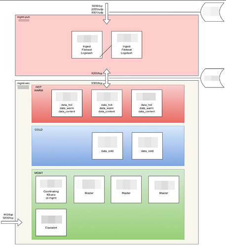

We shall do an upgrade from 7.10.2 to 7.17+ and have tried this is lab env.
But one question that comes to mind is, how is the cluster going to react when starting a snapshot on over 10TB data with cold storage?
We are using an NFS share as snapshot storage, and the cold data are almost 8TB of the total data.
Is this going to make a huge performance footprint on the cluster as a whole, or is it just going to take a huge amount of time :slight_smile:
HOT/WARM: 1.4TB
COLD: 7.5TB
One thought was to exclude the COLD data for snapshots, but it seems that I cant find if it is possible to make such exclusions.
