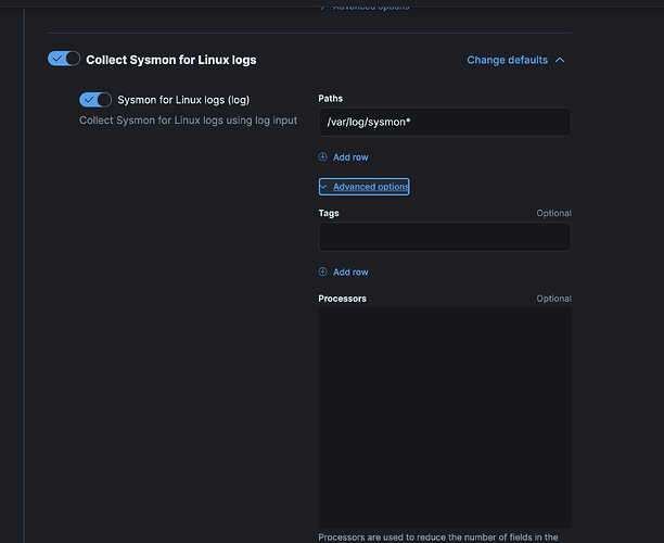

I only just now because of your help figured out where I am able to change these settings for these integrations. I was constantly clicking on the integration itself within my policy Kibana which only has a settings menu, but it's actually the integration policy that I should edit. Because of that I also never was able to find where it actually looks, or change/verify any other system integration, that clears things up a lot thanks.

I think I am on the right track now, I will report back once I output everything to a new file ../sysmon*. I would include more pictures, but because my account is new I can only post one.

I think I now confirmed the problem is 2 fold;
Problem 1 is that the integration looks for /var/log/sysmon* and these files don't exist yet with my current sysmon install. I believe this is simply how ubuntu handles these logs by default, based on the fact that splunk integration for Sysmon for linux also monitors journald. Some events did enter the syslog file earlier, and I am still trying to figure out when they dont and when they do, ubuntu has a drop in file for journald that does specify it should forward to syslog. I have the feeling I now have way less events for sysmon, because I am actually using a config now. But it should be relatively straight forward to get it to a new file called /var/log/sysmon*.
Problem 2 however is that Sysmon on Linux is not reading and logging any of my monitored events at all that are set in my config. When I restart sysmon service, can see those restart events as sysmon events via journalctl just fine, but I cannot see any other events that i am trying to log. When I create a process, file, or network connection as a test on a different terminal tailing journalctl, I am not getting any events back for that. Which means that probably there is more wrong with my sysmon installation/configuration. I read that auditd needs to be set up which is working and those logs I am getting properly, so I am not sure what is wrong with my setup.

You can point the integration to whatever file you like. I was just trying to isolate the problems. That's a good way to debug.
You might be able to have all the data go into syslog and add something to the Sysmon integration to drop the other events...

The problem I had was until your first comment I was never able to find where the integration sysmon for linux was looking, because I was clicking on the integration itself in my agents policy which has only the uninstall option, instead I had to click on the integration policy, There in that menu I was indeed able to find and configure the file, until your comment I had not found or noticed this difference yet.
