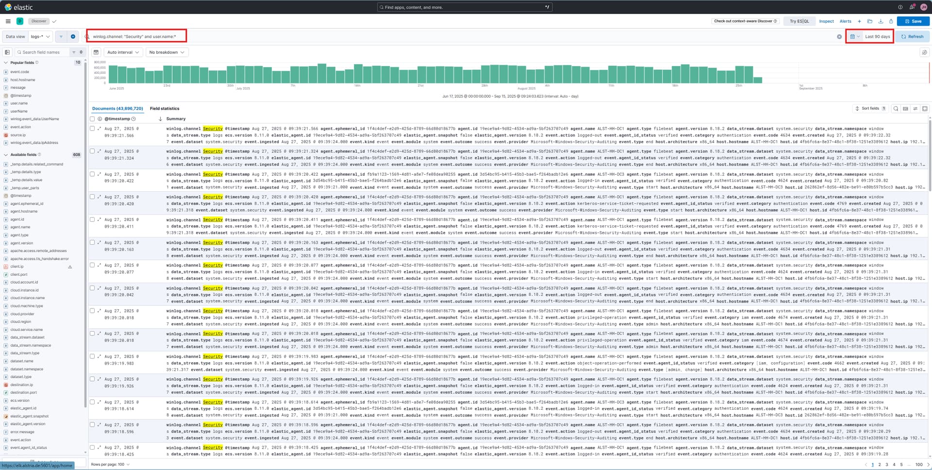

Hello all,
I have been running into the issue, that after updating my On-Prem Elastic-Stack (Single-node cluster) from v. 8.18 to 8.19 and the system integration for fleet as well, that the Windows security logs are missing some fields, or to be precise everything with user.*. Logs are still sent, everything else works as expected, as far as I can tell. Only my custom Dashboards as well as the default Windows Security Dashboards shipped with the system integration are not usable anymore due to the mapped fields.
Currently I am running v. 8.19.3 and v. 2.6.0 for the system integration. I tried updating the stack to the newest version as well as the system integration and redeploying the agent on the domain controller. I am not sure how to proceed or further troubleshoot this.

      "wineventlog"
    "event.provider.keyword": [
      "Microsoft-Windows-Security-Auditing"
    "elastic_agent.snapshot": [
      false
    "host.id": [
      "596edf47-0f75-4550-b1f0-5f411df71934"
    "agent.type.keyword": [
      "filebeat"
    "agent.ephemeral_id.keyword": [
      "404fc75a-d67e-4a1e-8b8f-194f4b262ae8"
    "agent.name.keyword": [
      "ALST-HH-DC2"
    "elastic_agent.id": [
      "feac96be-3a6d-4f36-a001-f223c416a1ef"
    "event.action": [
      "User Account Management"
    "@timestamp": [
      "2025-08-29T13:06:33.550Z"
    "winlog.channel": [
      "Security"
    "host.os.platform": [
      "windows"
    "data_stream.dataset": [
      "system.security"
    "winlog.event_data.TargetDomainName": [
      "DOMAIN"
    "winlog.opcode": [
      "Info"
    "agent.ephemeral_id": [
    "winlog.event_data.SubjectDomainName": [
      "DOMAIN"
    "winlog.event_id.keyword": [
      "4725"
    "winlog.event_data.SubjectLogonId.keyword": [
      "0x57c99044"
    "host.architecture.keyword": [
      "x86_64"
    "elastic_agent.id.keyword": [
    "winlog.provider_guid": [
      "{54849625-5478-4994-a5ba-3e3b0328c30d}"
    "winlog.provider_name": [
    "host.os.build.keyword": [
      "20348.4052"
    "winlog.event_data.SubjectUserName.keyword": [
      "adminaccount"
    "event.code.keyword": [
      "4725"
    "winlog.computer_name": [
      "ALST-HH-DC2.domain.local"
    "ecs.version.keyword": [
      "8.0.0"
    "host.ip.keyword": [
      "192.168.20.48"
    "winlog.keywords": [
      "Überwachung erfolgreich"
    "winlog.record_id": [
      547042761
    "winlog.event_data.TargetUserName.keyword": [
      "useraccount"
    "winlog.keywords.keyword": [
    "event.kind.keyword": [
      "event"
    "host.os.name": [
      "Windows Server 2022 Datacenter"
    "log.level": [
      "informationen"
    "event.action.keyword": [
    "host.id.keyword": [
    "host.name": [
      "alst-hh-dc2"
    "event.kind": [
      "event"
    "host.os.version.keyword": [
      "10.0"
    "winlog.event_data.TargetUserName": [
      "useraccount"
    "event.original": [
      "<Event xmlns='http://schemas.microsoft.com/win/2004/08/events/event'><System><Provider Name='Microsoft-Windows-Security-Auditing' Guid='{54849625-5478-4994-a5ba-3e3b0328c30d}'/><EventID>4725</EventID><Version>0</Version><Level>0</Level><Task>13824</Task><Opcode>0</Opcode><Keywords>0x8020000000000000</Keywords><TimeCreated SystemTime='2025-08-29T13:06:33.5504032Z'/><EventRecordID>547042761</EventRecordID><Correlation/><Execution ProcessID='804' ThreadID='2612'/><Channel>Security</Channel><Computer>ALST-HH-DC2.domain.local</Computer><Security/></System><EventData><Data Name='TargetUserName'>useraccount</Data><Data Name='TargetDomainName'>DOMAIN</Data><Data Name='TargetSid'>S-1-5-21-338608204-2689096227-197484634-11695</Data><Data Name='SubjectUserSid'>S-1-5-21-338608204-2689096227-197484634-12233</Data><Data Name='SubjectUserName'>adminaccount</Data><Data Name='SubjectDomainName'>DOMAIN</Data><Data Name='SubjectLogonId'>0x57c99044</Data></EventData><RenderingInfo Culture='de-DE'><Message>Ein Benutzerkonto wurde deaktiviert.\r\n\r\nAntragsteller:\r\n\tSicherheits-ID:\t\tS-1-5-21-338608204-2689096227-197484634-12233\r\n\tKontoname:\t\tadminaccount\r\n\tKontodomäne:\t\tDOMAIN\r\n\tAnmelde-ID:\t\t0x57C99044\r\n\r\nZielkonto:\r\n\tSicherheits-ID:\t\tS-1-5-21-338608204-2689096227-197484634-11695\r\n\tKontoname:\t\tuseraccount\r\n\tKontodomäne:\t\tDOMAIN</Message><Level>Informationen</Level><Task>User Account Management</Task><Opcode>Info</Opcode><Channel>Sicherheit</Channel><Provider>Microsoft Windows security auditing.</Provider><Keywords><Keyword>Überwachung erfolgreich</Keyword></Keywords></RenderingInfo></Event>"
    "winlog.event_data.SubjectDomainName.keyword": [
      "DOMAIN"
    "data_stream.type": [
      "logs"
    "ecs.version": [
      "8.0.0"
    "event.created": [
      "2025-08-29T13:06:34.655Z"
    "host.hostname.keyword": [
      "ALST-HH-DC2"
    "agent.version": [
      "8.19.2"
    "winlog.event_data.SubjectUserSid.keyword": [
      "S-1-5-21-338608204-2689096227-197484634-12233"
    "host.os.family": [
      "windows"
    "log.level.keyword": [
      "informationen"
    "winlog.computer_name.keyword": [
    "host.os.build": [
      "20348.4052"
    "host.os.kernel": [
      "10.0.20348.4050 (WinBuild.160101.0800)"
    "host.os.name.keyword": [
    "winlog.provider_guid.keyword": [
    "winlog.task": [
    "winlog.task.keyword": [
    "host.mac.keyword": [
      "00-50-56-9A-28-CC"
    "data_stream.namespace": [
      "windows"
    "winlog.event_data.SubjectUserName": [
      "adminaccount"
    "message": [
      "Ein Benutzerkonto wurde deaktiviert.\n\nAntragsteller:\n\tSicherheits-ID:\t\tS-1-5-21-338608204-2689096227-197484634-12233\n\tKontoname:\t\tadminaccount\n\tKontodomäne:\t\tDOMAIN\n\tAnmelde-ID:\t\t0x57C99044\n\nZielkonto:\n\tSicherheits-ID:\t\tS-1-5-21-338608204-2689096227-197484634-11695\n\tKontoname:\t\tuseraccount\n\tKontodomäne:\t\tDOMAIN"
    "winlog.event_id": [
      "4725"
    "winlog.channel.keyword": [
      "Security"
    "host.os.family.keyword": [
      "windows"
    "host.os.type.keyword": [
      "windows"
    "host.os.platform.keyword": [
      "windows"
    "winlog.event_data.TargetSid.keyword": [
      "S-1-5-21-338608204-2689096227-197484634-11695"
    "winlog.opcode.keyword": [
      "Info"
    "event.dataset": [
      "system.security"
  "ignored_field_values": {
    "message.keyword": [
    "event.original.keyword": [
I have not found anything similar regarding the system integration. Is someone able to point me into the right direction on how to further proceed? Thank you in advance.
Hello, I still have not found any solutions to this issue. Is there someone able to assist in any way? Thank you.
It seems the processors for winlog.event_data.SubjectUserSid and .TargetUserSid are missing in the config on the server after the update under the system.security dataset. I am not certain if this is by design or not and if just adding those manually might fix it.
