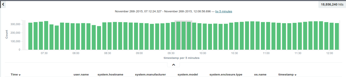

just use timestamp: ["2015-11-04T11:12:13" TO "2015-11-04T11:20:20"] .
But as @warkolm said, you should be specifying your index (in kibana settings) as a timestamped index.
Then you'll have a histogram at the top of the discover page and you can simply scrub the graph to filter on a timerange.
And there will also be a "time selector" in the toolbar.
