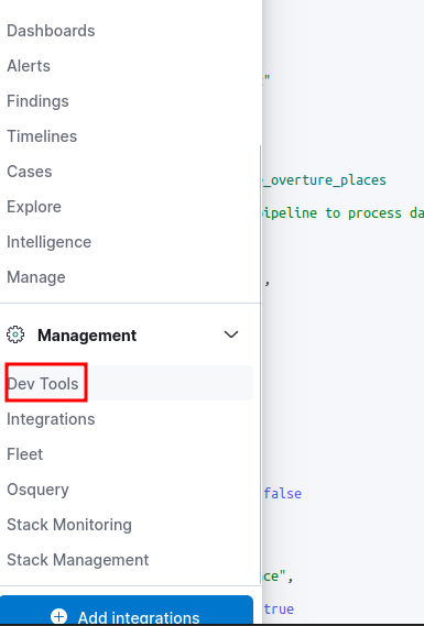

Sorry, I was not explicit about that. The code shared above is expected to be run from the Kibana Console in the Dev Tools section of the Management block in the Kibana sidebar. That application is independent of Logstash.
The code I shared creates an index, then insert some documents using the Bulk API, to finally execute the runtime field directly on a search request.
