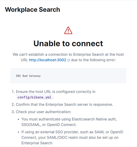

Hi ELK Team,
I set up Elastic stack in separate docker containers on my local machine.
It is build based on the following Github repository:
https://github.com/deviantony/docker-elk

Elasticsearch and Kibana are working well. But Enterprise Search within Kibana does not work. I have tried so much on this, still no solution.
Below are the error logs:
workspace-kibana-1         *| [2022-04-03T03:19:31.484+00:00][ERROR][plugins.enterpriseSearch] Could not perform access check to Enterprise Search: FetchError: request to http://localhost:3002/api/ent/v2/internal/client_config failed, reason: connect ECONNREFUSED 127.0.0.1:3002*
Your help will be much appreciated
