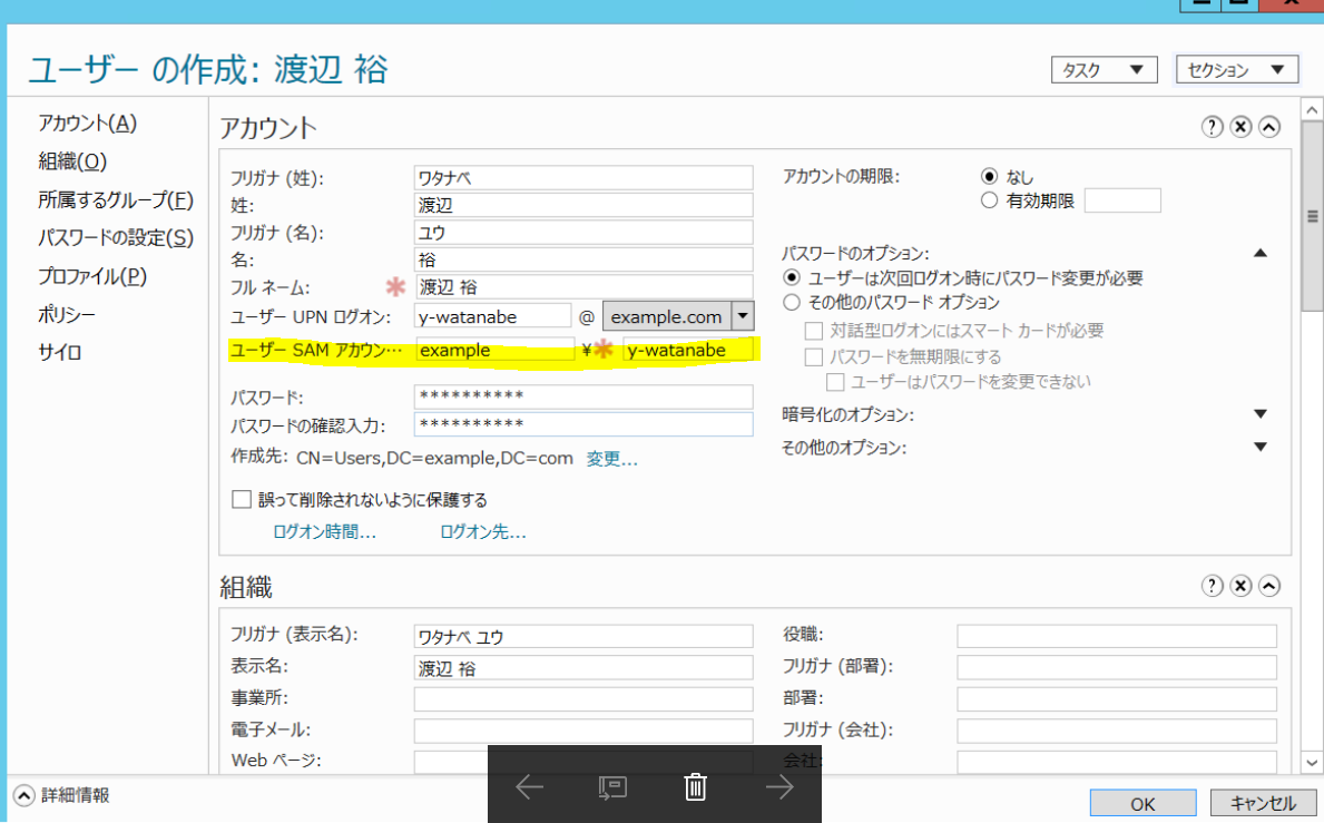

I have my AMA account configured fine like below.
Authentication works fine with UPN . Below is my elasticsearch.yml.

It looks like you are trying to use the down level login name and not just the sAMAccountName. What happens when you try using just y-watanbe? Also in your configuration you have the domain as ad.example.com but in your screenshot the domain is example.com; are you sure that your configuration is correct?
