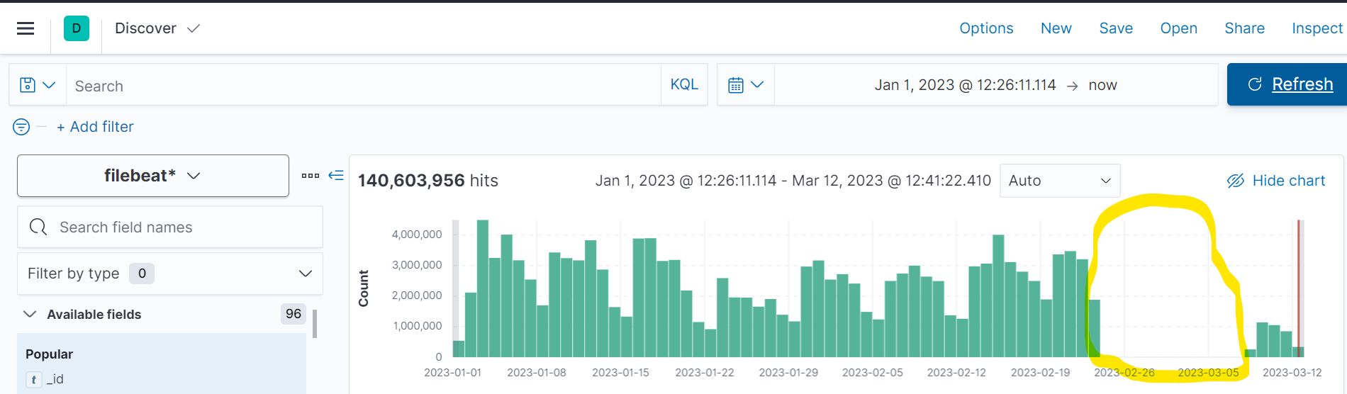

On Stack-management I can see indices for specific period as health status open and yellow, and it was under rollover state as per lifecycle for example filebeat-7.0.13-2023.01.14, it means logs from 14th Jan the till 8th Feb logs were inside this indices which is got rollover and our appdev team could not able to see the logs
but on the discovery specific period logs were missing as mentioned below screenshot

You have a lot of very small indices which is bad. It looks like you are generating several indices per day.
It is recommended that you try to achieve a shard size in the range of GB and your indices are a few MB in size. I would recommend changing your ILM policy to roll over at e.g. 5GB and 7 days (assuming you have a retention period exceeding a coupe of months). This should result in fewer larger indices, which would be a lot better.
With respect to the problematic index it seems you have lost it, so you will most likely need to restore it from a snapshot.
