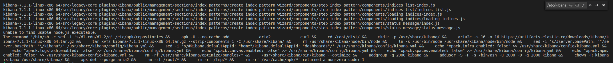

/usr/share/kibana/bin/../node/bin/node: bad option: --max-http-header-size=65536. (Kibana 7.1.1)
Issue
I keep on getting the following error when I compose the kibana docker file
unable to find usable node.js executable.
Attached is the docker image code

Well now i am getting

I'm not totally familiar with node's alpine linux version, I'm assuming it was compiled from source and the header size option hasn't been added yet. It was added in a more recent node.js version.
If you want, you can try removing the flag from the bin/kibana. The default is now 8kb and we saw some cases where headers were too long when generating reports, but otherwise functionality was fine.
Alternatively using the node.js bundled with Kibana would work :slight_smile:
