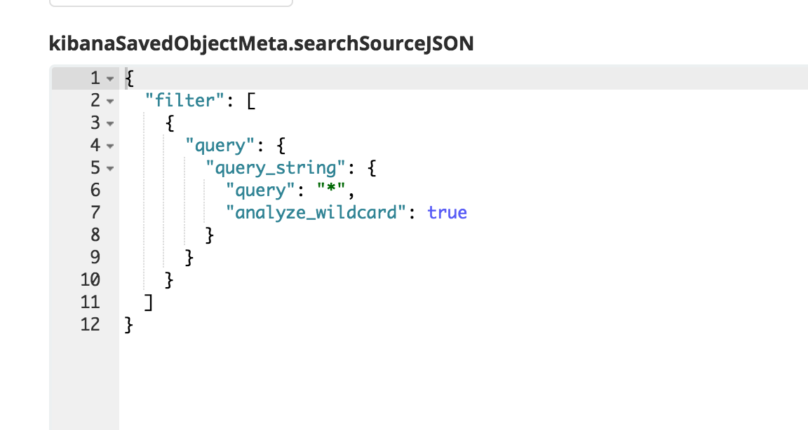

Indeed the highlightAll part seems to be the problem. Which version did you export that data from? Whichever it was, looks like we don't support that syntax in 5.2. If you go into Management > Saved Objects, you should be able to clean up the dashboard source to remove that portion.
E.g. this:
should instead look like this:
Save the dashboard object and try to reopen, see if that fixes the issue like it did for me when I had that extra data in there!
