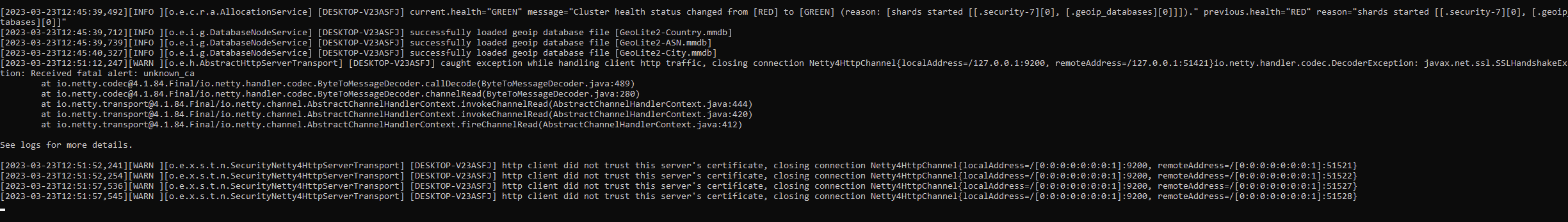

Update: so I have tried running the elasticsearch exe without any browser or anything else open and it seemed to be working fine, but it then stopped updating on the cmd so I tried checking it by going to https://localhost:9200/
Now I got different errors displayed:

The unknown_ca issue may be a little trickier. I will see if I can find something to help you and report back.
