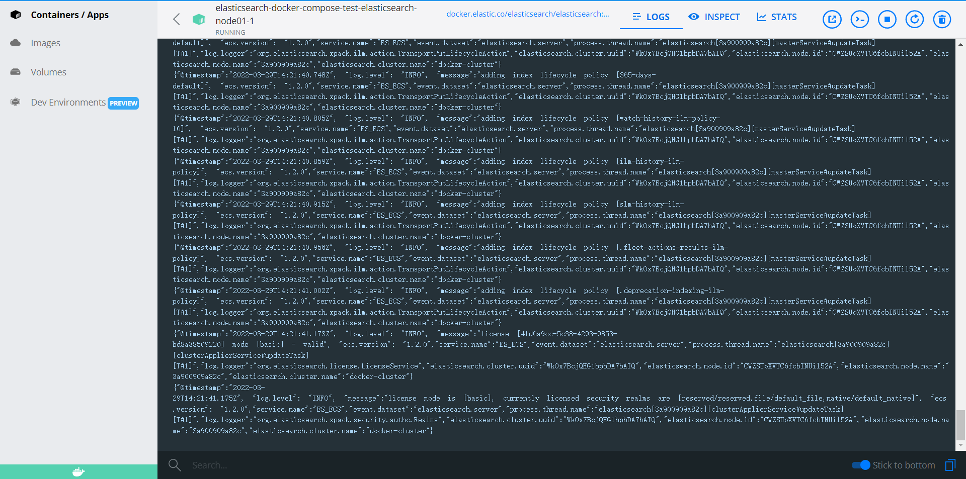

  • For kibana, it is very smooth, but for Elasticsearch, an exception is thrown and the corresponding service is aborted, which confuses me. The following is the log output by Elasticsearch on the docker daemon.
Exception in thread "main" java.nio.file.FileSystemException: /usr/share/elasticsearch/config/elasticsearch.yml.cvrM1wfsRz-M7StPG7vFHw.tmp -> /usr/share/elasticsearch/config/elasticsearch.yml: Device or resource busy
