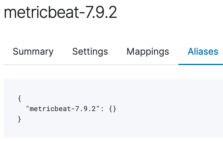

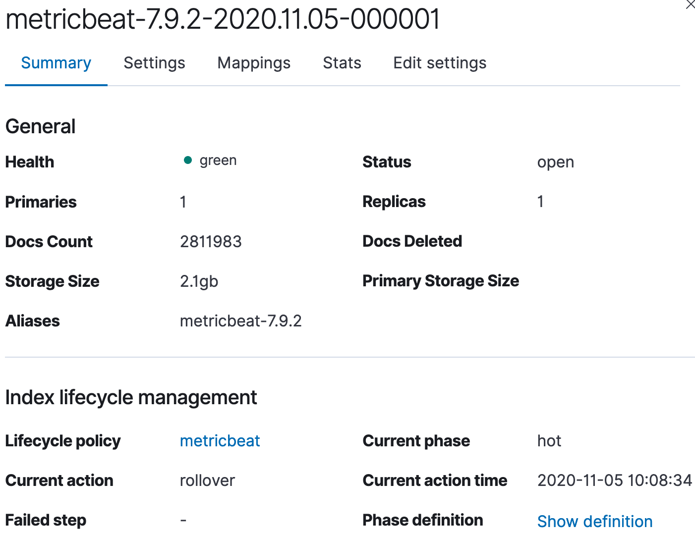

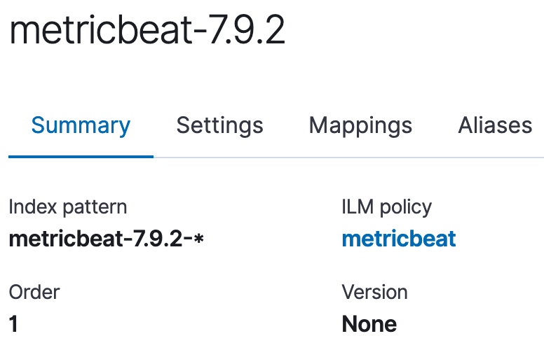

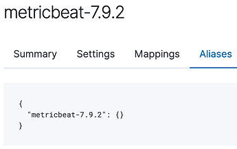

I did whatever need to be, still no hope. Lemme explain;
I have these many indices :point_up_2:
And this is my metricbeat index I am concerned about :point_up_2:

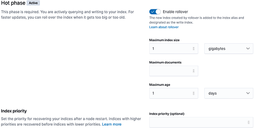

This is my ILM policy :point_up_2:

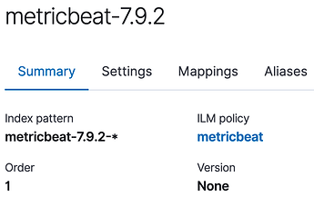

These are my templates :point_up_2:
And this is the template explained :point_up_2:
Below is my ILM policy explained.
PUT _ilm/policy/metricbeat
  "policy": {
    "phases": {
      "hot": {
        "min_age": "0ms",
        "actions": {
          "rollover": {
            "max_age": "1d",
            "max_size": "1gb"
          "set_priority": {
            "priority": null
      "warm": {
        "actions": {
          "set_priority": {
            "priority": null
      "delete": {
        "min_age": "2d",
        "actions": {
          "delete": {
            "delete_searchable_snapshot": true
As per the policy, the index should be max 1 GB size and 1 day old. This index was created yesterday and more than 1 GB size (pri 1.1GB, total 2.1GB). How to fix this?
