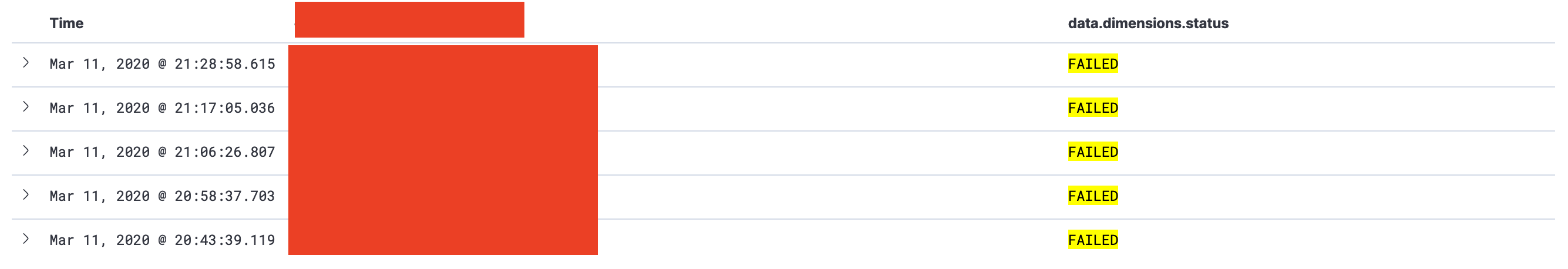

I have Kibana alert where I am NOT getting all alerts. This is inconsistent behavior where it works some times and sometimes not. I am not sure why.
Based on my condition I am checking certain status every minute (now - 1m). Kibana had 5 incidents that fits this criteria but only received for alerts.
FYI, this alerts are being sent to Slack channel. Below is the case where I have 5 events but only 4 alerts.

I have attached screen shots of log entry and alerts so when you say "can u plz capture the logs and compare it to the time when it does not trigger ?", isn't that sufficient info?
What else I should be looking at? I tried your approach as well where my alert logic returns results.
The issue I am running into is, I can see logs entry for events but alerts are not consistent (i.e. 5 events in logs but only 4 alerts). This tells me that alert logic is correct.
