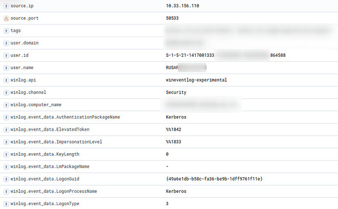

in Winlogbeat I recently switched from the default windows event log API to the experimental one, because winlogbeat was capping out at roughly 1800 events per second and our Windows event collector getting a lot more than that. While the EPS increase is truly great, I noticed a very weird behaviour afterwards, which I would consider a bug.
With the new API there is a mismatch between the parsed fields and and the rendered content field. They simply don't match each other as if they were taken from two different events. For example these two are fields from the same event in my Elastic:
As you can see, the rendered content doesn't match the parsed fields. This only happens using the experimental API to ingest the events in winlogbeat. The moment I switch back to the classical API the fields match but then I can't get enough performance to keep up with my inbound logs.

Can you share the full document JSON (the _source part) with redactions as needed.
Sure, a tiny bit redacted but mostly complete:
"_source": {

I also tried to do some scoping. Looks like this doesn't happen on all Windows events. The only event ID I could confirm it on is Windows event ID 4624 (successful login).
Plus it looks like the rendered text (log.original) is always the same over multiple events. Cloud it maybe be some caching issue? The original Github issue about the new experimental API mentions that there is caching in place https://github.com/elastic/beats/pull/17022
Where is log.original coming from? That's not a field that Winlogbeat produces AFAIK (it uses message).
That comes out of my own parsing chain. Since I favor logstash over Elastic ingest pipelines and have a big logstash pipeline for multiple things in place my setup (for windows logs) is like this:
Windows Event Collection => Winlogbeat => Kafka => Logstash => Elastic
One of the very few things done on Logstash is renaming message to log.original. Haven't caught up to the latest ECS versions (log.original vs. event.original) yet.
The issue is already visible on Kafka though. So it is clearly something coming out of Winlogbeat.
