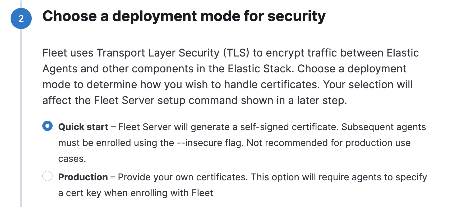

I add my fleet server with quick start parameters.
  1. My first try => I put my informations : Name and https://MYIP:8220
    Generate fleet server policy
    and install "fleet server to a centralized host"
    But when i install i see : "message":"Generating self-signed certificate for Fleet Server"
    And when i want to enroll agent into fleet : Error: fail to enroll: fail to execute request to fleet-server: x509: certificate signed by unknown authority

I just did this
Took about 5 minutes, I did the quick start method, not advanced
Worked fine it created It's own certs and then I just use the --insecure flag for the agents
