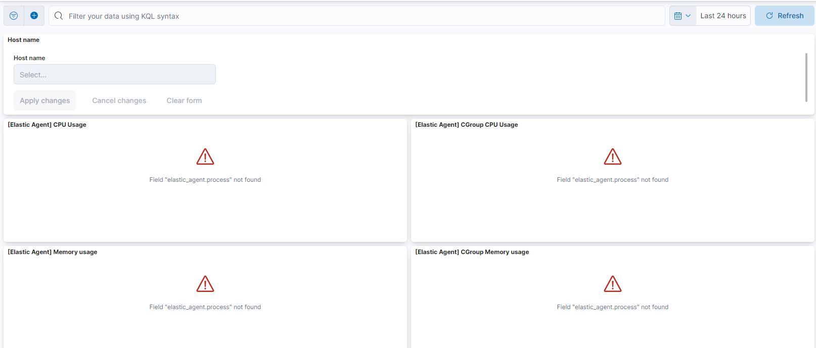

Both server and agent were green and healthy but after few minutes both turned yellow and unhealthy.
if i restart them they become healthy for few minutes and then turn to unhealthy.
In the minutes where both are healthy there are no logs coming.
