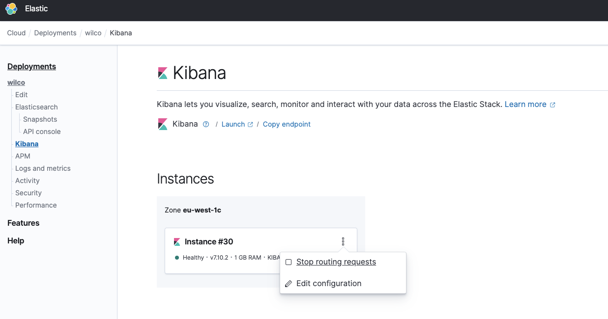

and here is what I call stop routing requests

Oh, I see.
That will prevent your cloud kibana instance from receiving http requests, but it will still try to run tasks, so doing that won't help.
