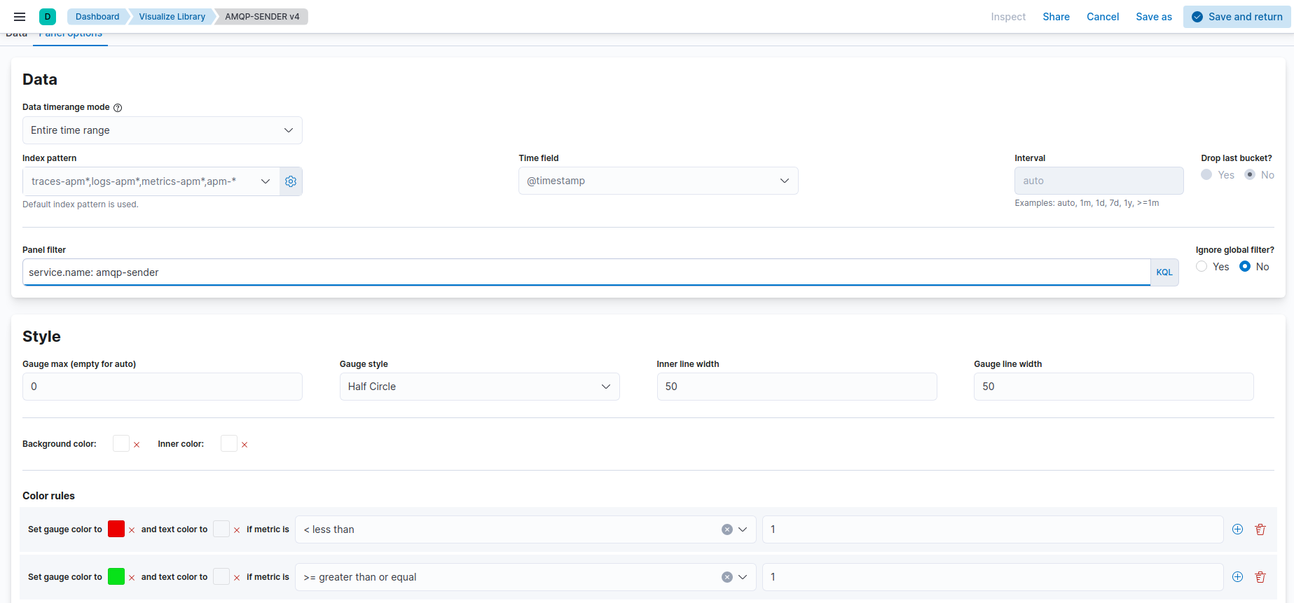

As a workaround, users can create gauges like this:
custom gauge configuration:
