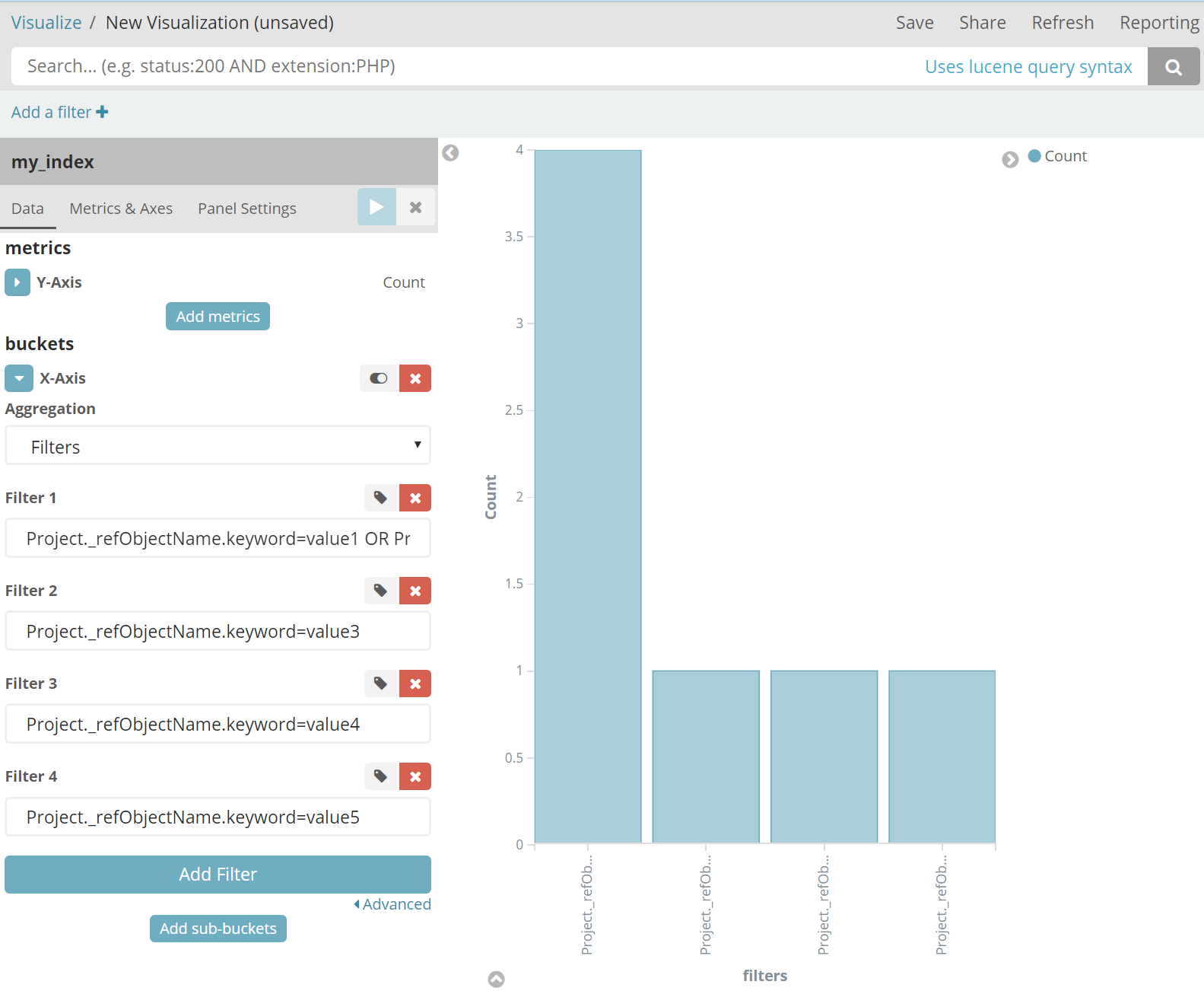

And then I made this visualization which shows a terms aggregation on that scripted field. Since there are 2 docs with value1 and 2 docs with value2 the chart shows a count of 4 docs with the value of value1or2;
I can also create the same chart without using the scripted field by using a Filter aggregation (the first filter is Project._refObjectName.keyword=value1 OR Project._refObjectName.keyword=value2
Hi @LeeDr
I've tried that before - it causing an error that related to unsupported files
But the 2nd option works great ! I think for now it's good enough for me.

BTW: using filtering in visualize exist from which version ?
I see the Filter aggregation being available as far back as 4.6.5 version of Kibana, probably earlier than that.
