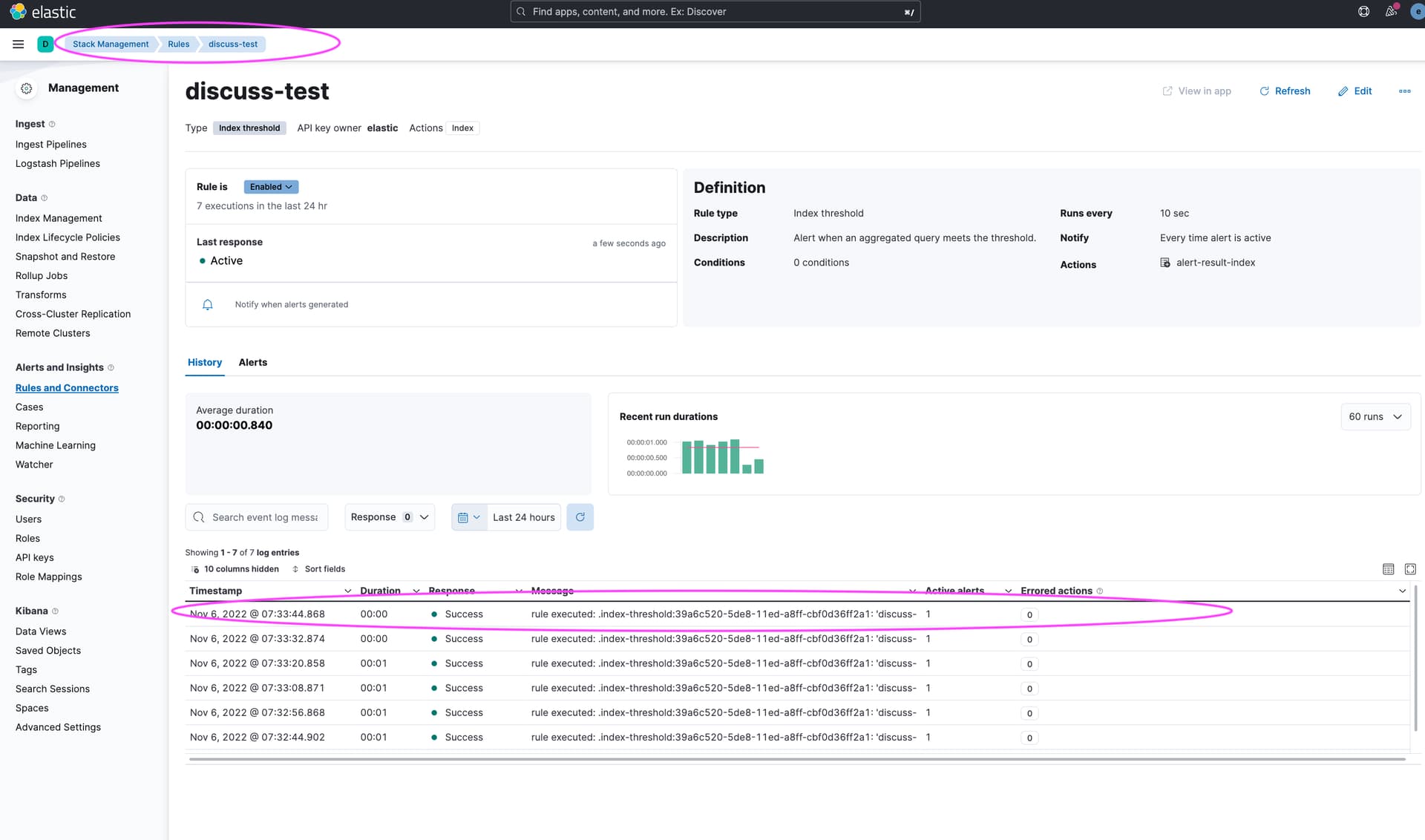

Please show screenshots/ code of the the type of alerts (There is no Index Rule, there is an Index Action) entire rule setup and test outcome and the action. We can't debug the rule without seeing it.
Did you set up an index connector?
Are you sure there are documents that meet the threshold within the time frame?
When you check on the rule execution and the details what do you see?
There is a ton of information there...
