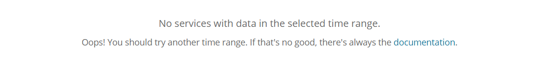

When I start the server with ./apm-server -e -c apm-server.yml, the logs don't give me any error, it goes well, but I don't receive in Kibana any data of the services:
The time range in Kibana is well configured, because I have done some requests to elasticsearch with curl and I can't see this information here or in the dashboards.
