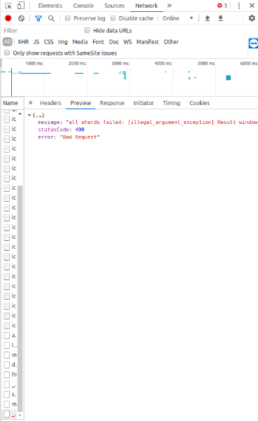

It seems like several requests are failing with a 400 status code. Could you switch to the network tab and copy request and response of one of the failing requests?
Only one 400 error all else are 304.
This is 400 error :-
The screenshot is cut of in an unfortunate position, could you copy/paste the "Response" tab in its entirety?
This is the response:-
{"message":"all shards failed: [illegal_argument_exception] Result window is too large, from + size must be less than or equal to: [10000] but was [1000000]. See the scroll api for a more efficient way to request large data sets. This limit can be set by changing the [index.max_result_window] index level setting.","statusCode":400,"error":"Bad Request"}
I can reproduce this problem when setting savedObjects:listingLimit to 1000000 in the advanced settings. Elasticsearch doesn't allow fetching so much data at once.
However this problem shouldn't manifest in such a way, I created two issues to improve this: https://github.com/elastic/kibana/issues/58730 https://github.com/elastic/kibana/issues/58733
Please set savedObjects:listingLimit to 10000, then Dashboards should work fine again.
This solved the issue. Thank you.
