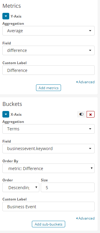

My bucket looks like this:

Hey @Robert_Naccache I'm having trouble recreating this issue on 6.1.3, could you mind attaching a screenshot of the full chart configuration?
by full chart configuration, you mean this?
Just to kind of show you, i left the mouse over and you can see that the value is 55.979
Once i click on the buisness event (to filter it out)
Value drops to 18.66 (which is the correct one, i aggregated it on elasticsearch)
Weird thing is, if i change the bucket "order by" to some other metric (i.e. by max value) it works normally.
Hey @Robert_Naccache the values that we display here come from Elasticsearch and are likely a result of the following: https://www.elastic.co/guide/en/elasticsearch/reference/current/search-aggregations-bucket-terms-aggregation.html#search-aggregations-bucket-terms-aggregation-approximate-counts
